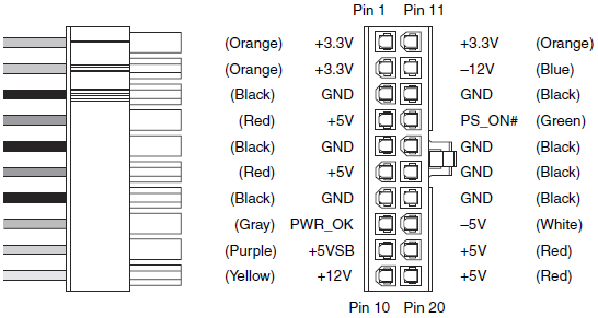

Does the PSU have a standard ATX style main power connector?
If so, connect a multimeter to pins 7 and 9. Are you getting a reading of between 4.9 and 5.1 volts?

Dwarf, That diagram was awesome. Thank you. Did what you said to do, and still nothing showed on the multimeter.

One thing that I forgot to mention - was the wiring to this connector the same as shown in my diagram, i.e. the colours? Did you have the PSU plugged in and powered on for that test?
The reason for choosing this pin is that 5V is ALWAYS available here; this is what powers your system when it is sleeping (maintains the data in RAM) and allows other functions such as Wake On Lan, etc.
If you have no reading here, then it is likely that the PSU has failed. If this is the case, and I'm afraid that it is looking likely, then you will need to replace it. Fortunately, if it is a standard unit, this is simple to do. Make sure that the replacement is of equal or greater rating, preferably greater, than the old one.

Dwarf, Yes the coloring was the same are your diagram. I tired testing with the MM both plugged in and unplugged ( was unsure, and it wasn't going to hurt anything).
