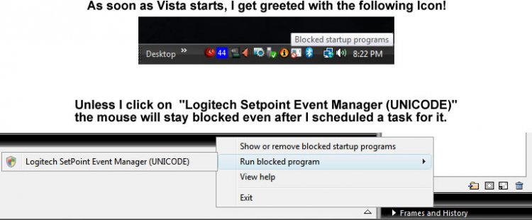

Shawn, I followed the instructions to make a scheduled task for the mouse but it didn't do anything and I don't think I did it wrong since I followed instruction, although, I may have done it wrong by the looks of it... I still have to click on it to make it work (see attachment).
All I remember doing was making the mouse run as administrator, it asked me a few questions and then, at start up, I had to do what you see on the attachment. I have not tried to uninstall setpoint to see if that will cure it because I have all my custom game setting and I don't want to loose that. :(

That is Defender blocking the program.
I seriously doubt that since I have defender DISABLED but, anything is possible I guess. I don't recall what I did to disable Defender, can you guys tell me where to go check (just for good measure of course! ;)) :p
At any rate, I think I have it licked but I am to tired and to lazy to try it now. I knew I had seen this here and even though the link is from another forum, it came from a Gaming post.
SlickDeals.net Forums - View Single Post - Vista Blocked Programs at Startup- Fix Once and for All
I'll try it tomorrow and post back. something tells me that Brink (Shawn) was 85% right on this one but I had forgotten 1 little step in the process.

Well, that link work work, though, I still would like to know why I had to do it that way since sygnus21 said he didn't have to.
Being said that, I am not that lucky so I won't touch it any more, I like that saying... if it ain't broke, don't fix it! :D
