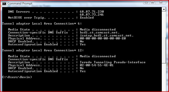

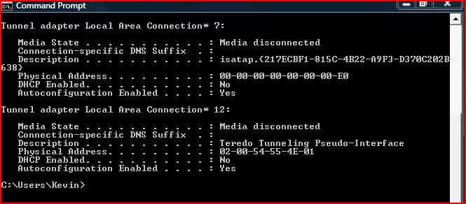

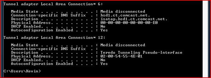

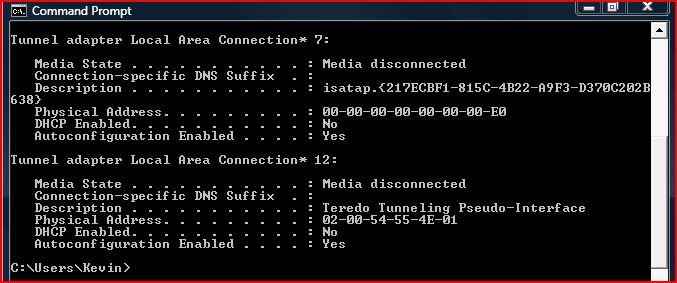

Thanks Josh.
I followed the steps described in your post.
Here is the snip. I had to do it twice because it wouldn't all fit in one snip. Sorry.
I also ran the file int the link.
One thing of note is after I changed the network to "Private", it went back to "Public" after the automatic restart.
Is that normal?

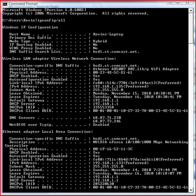

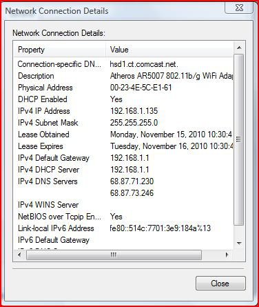

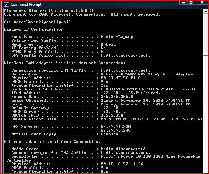

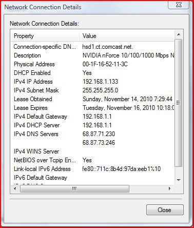

Here are the snips you requested Lorien. Thank you for the reply.
I took ships of the local hardwired network and the wireless network. It seems that I have 2 networks connected at the same time. 1 wireless and 1 hardwired. I'm sorry, but I'm starting to get very confused and if I am not explaining myself correctly, I appologize.
When I unplug from the hardwired network my laptop will not connect to the wireless network that my othe computer is connected to. The wireless network is unidentified on my laptop. It does work on the desktop using XP
Either I misunderstood Josh when I did the original snips or maybe you have misunderstood me. I'm sure I misunderstood since I am not super computer savy.
When I followed the directions from Josh, I did the ipconfig step with the hardwired network unplugged. I thought I was supposed to do it with the wireless network only based on what he wrote.
Lastly Make sure you only have a Wireless connection when you Follow the Steps
Did I do that incorrectly?
Here is the snip of the ipconfig with with my computer hardwired through the router and with what I believe to be connected to a wireless network.
I hope these help and I'm sorry about the confusion.

Don't apologize. You did fine both times - exactly as instructed and just what we wanted to see (well, just what we requested - not precisely what I wanted to see). I requested something different than Josh because I wanted to see how the connections were showing up together and if they were interfering with each other.
Did you make the changes to DNS I requested before doing these snips? I still see the DNS connection addresses instead of the router's address (which is what I expected).
Please give us some time to analyze this information and try to figure out what is happening and possibly what to try or do next. Chances are good we'll need to run some additional tests.

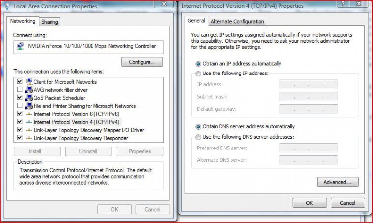

I did miss the last part of your post requesting more information on the DNS and IPv4 & 6 addresses along with the TCP/IP and the DHCP information.
I am at work this morning and I will get you the requested info as soon as I get home this afternoon.
Thanks for being patient and thanks for all your help.
    HP

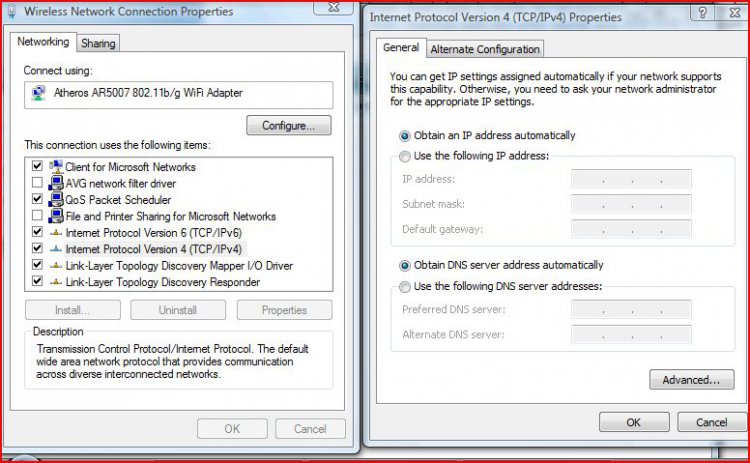

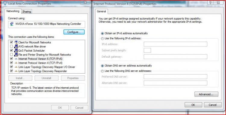

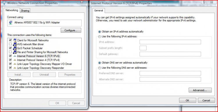

Well. I'm home from work and ready to to the step that I forgot to do last night.
When I go to manage networks, both of the networks are shown. I will perform the actions on both networks.
Both networks were set to automatic and did not have any fields with info.
I don't believe that I need to snip another ipconfig/all because I did not change anything.
Hope this helps.

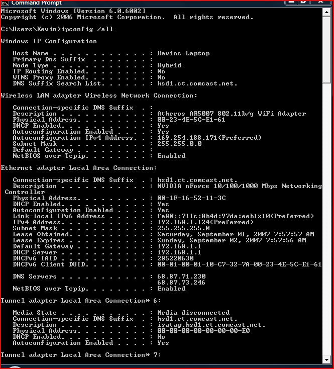

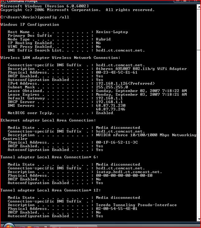

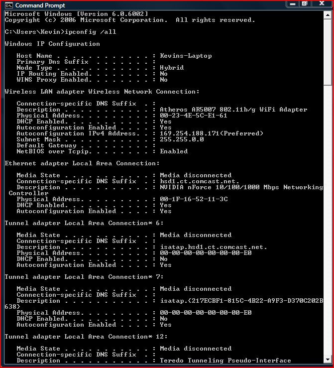

OK, thanks. I did not post an ipconfig /all snip because it was the same as earlier posts from a couple weeks ago. The only difference was the ip address. Sorry, I didn't know it was needed again.
I followed the directions in the link and find the snip attached.
I ran the batch file as well.
Any help is appreciated.

OK,
That looks good. Is the wireless working?
Please post a picture of your "Network sharing center screen".

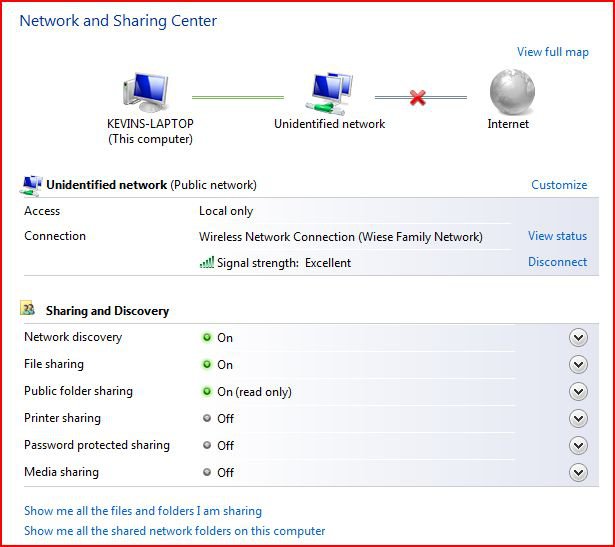

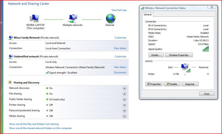

Thanks,

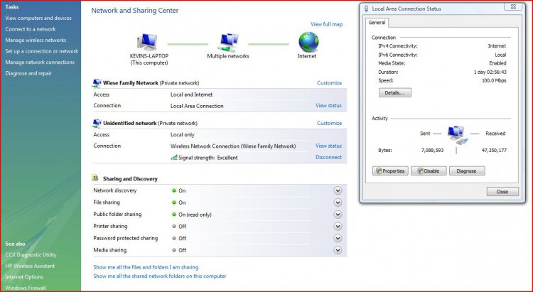

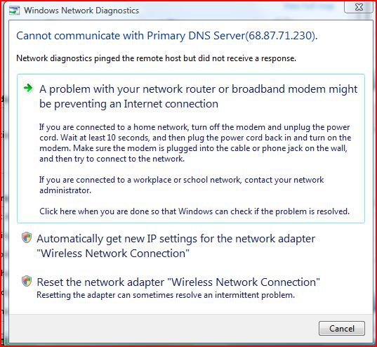

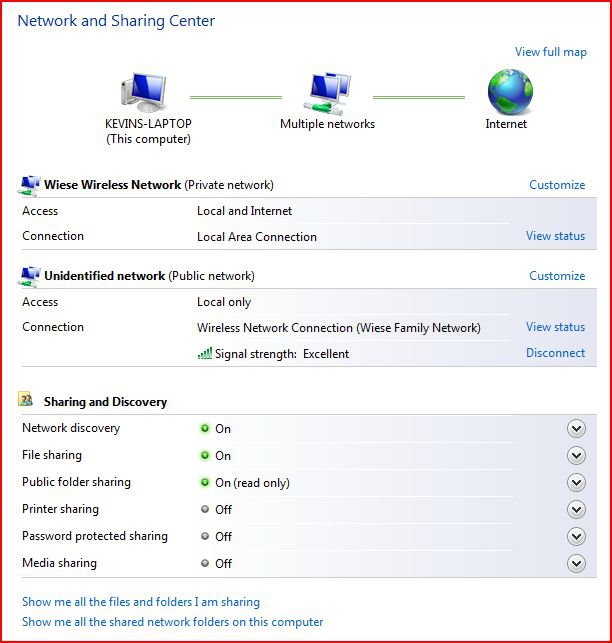

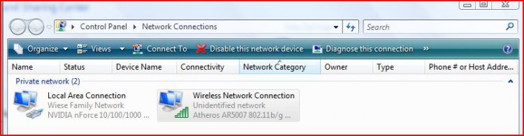

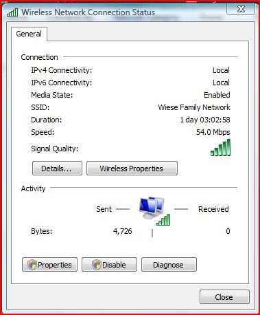

Here are some shots of my Network and Sharing Center page.
One snip is of what happens when I'm running wireless only with the "Unidentified Network" Local Only.
The other is when I'm hard wired and using the net. It shows the 2 networks.
The network that all of my other wireless computers connect to is the Family Network which seeems to work fine.

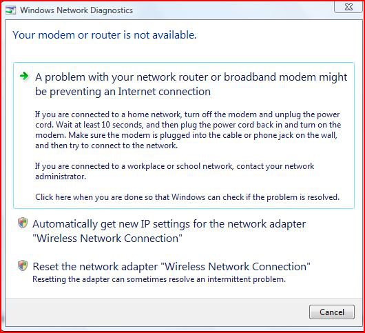

This is the error messsage I get when I click on the Red X.
Thanks

OK,
Looking at that go to the network and sharing control panel.
Manage my connections.
Look for how many & what connections are listed, the setting, passswords etc. will help to identify them? Then once you have identified the douplicate network connection, delete it.
This should then only leave the working one & all should be well.
