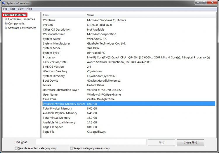

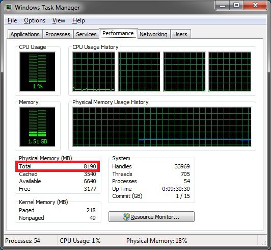

In Task Manager, do you have 510 MB listed as the Total?
What do you have listed as the Installed Physical Memory (RAM) in System Information?
to alien: yes, on total, it says 510 mb also it says 1.50 gb on installed physical memory (RAM), and 511 mb for total physical memory also how do i put a picture of my system information, i can't click the thing to attach a file

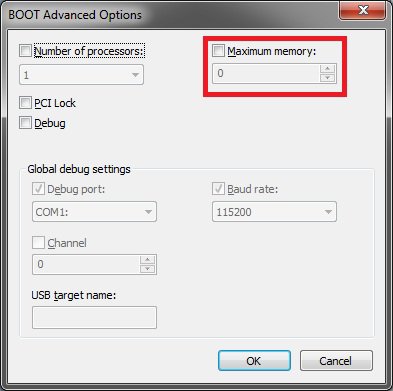

so are you saying i can EITHER uncheck it or put maximum memory on it?
i change the maximum memory to 1500 (1.5 gb) but everytime i go on it again, it's back to 512, does that possible mean i bought the wrong ram for my pc?
