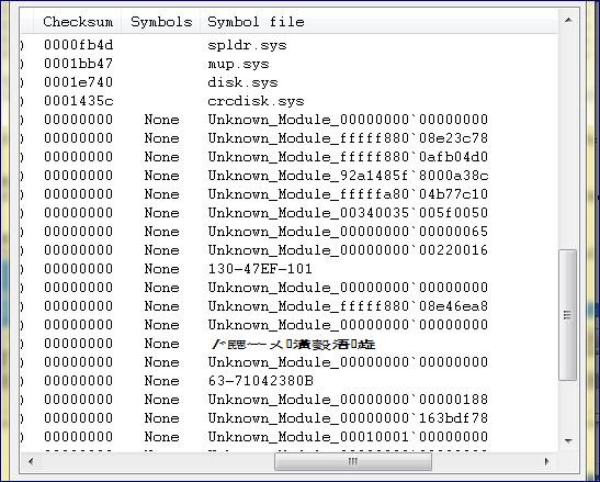

The dumps show definite OS corruption - source = unknown. Take a look at the drivers from one of the dumps - they should be in English - not "unknown", numeric addresses and certainly not characters that appear to be Asian.
I would suggest that you re-install the OS.
