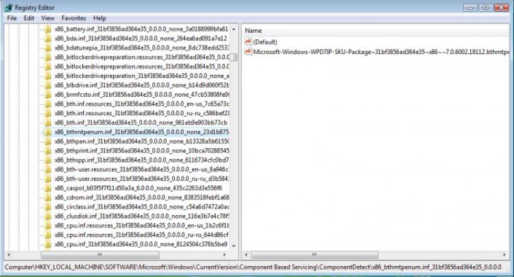

.If you cannot run system then you have to restore system
,probably you have to replace half system
(see yourself your own sfcdetails.txt).It's no strange here you can't run Readiness Tool.If you can try system restore (of course it will work only if you have any good checkpoint) ,if you can't run system restore on allive system boot special recovery disk
