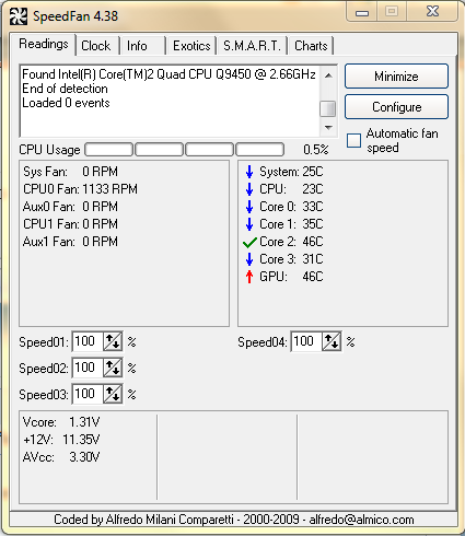

as others have said, its not a big drop really, 5-6c some claim up to a 10c drop.......
i also would never go WC, my air config is 2nd to none :) (if you dont mind a little noise, but while gaming with the headset it makes no odds)
i have a CM590 case with a full front grill, ive removed all standard CM 120mm fans & replaced all of them with server fans (2x 120x38mm delta's @ 135CFM each...... 3x 92x38mm AVC @ 100CFM & vantec @ 113CFM
all wired into a ''lamptron military bay bus controller''.....
while idle i run only one fan, the CPU fan @ 20%, & the rig is silent @ the flick of a switch im pulling 300CFM through the front of my case...:eek::eek: @ about 50db
this setup cost peanuts compared to a decent WC setup & mine probably performs better...
now this is a far less hassle & ''better performing'' setup than water, its just obviously louder... but a WC setup is not silent unless you keep your rad in another room, the 3x 120mm fans are still audible...
check out my idle & load temps...;)
idle....
load...

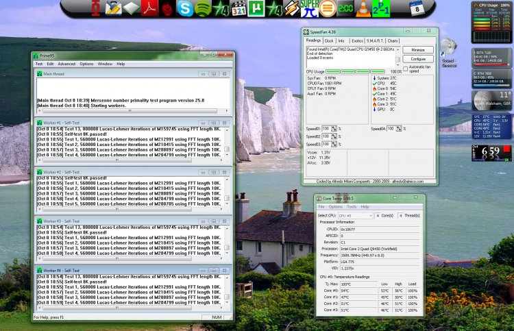

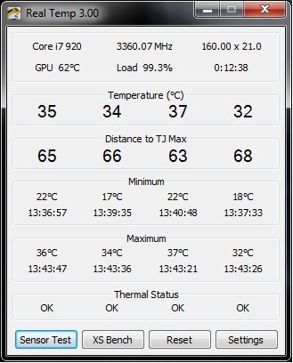

I've seen different outcomes with watercooling. If you don't set it up properly, then you get bugger all in terms of temp drop. If setup properly, then you can get quite a considerable drop in temp.
The PC a mate of mine has has watercooling in it, just one to cool the CPU. He had his radiator next to his PC under his desk, so was still sitting at 30C idle and in the 40s for load temps, which is pretty much what I get on my CPU on air cooling. He then moved his PC on to his desk and put his radiator on to his window ledge and that's when the temps really dropped.
At idle his i7 920 sits at 19-20C, it's been overclocked to 3.4GHz. At load, it gets to about 35C when running prime95, which leaves a lot of headroom for more overclocking when he upgrades his RAM from 1333MHz.
I'll try and get some screenshots when I see him.
Edit: He's posting the screenshot himself.
Edit: Just watched him take that screenshot and when prime95 has stoppedbenching , the temps drop back down to idle in pretty much a few seconds.

Im the guy "Everlong18" was talking about, at Idle my CPU sits at 15-22c and at Load the highest any core gets to is 37C.

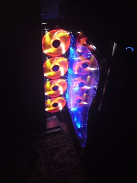

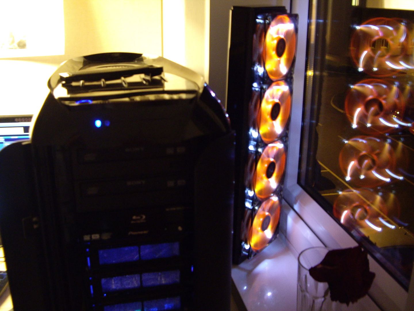

Its the "Black ICE GT eXtreme 480" 480mm Radiator, with a "Laing DDC-1T Ultra 18w" Pump, and The "Laing DDC Top Reservoir", with a EK-Supreme Plexi S1366 Block. The Radiator Has 4x Xigmatek 120mm orange/White Fans (See Pics Below!!!).
As you can see the radiator is right next to the tower.

He was too lazy to take a new photo. He currently has his radiator sat on his window ledge with the fans blowing cold air from the window through his radiator ;)

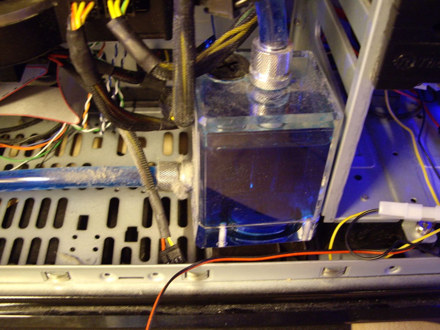

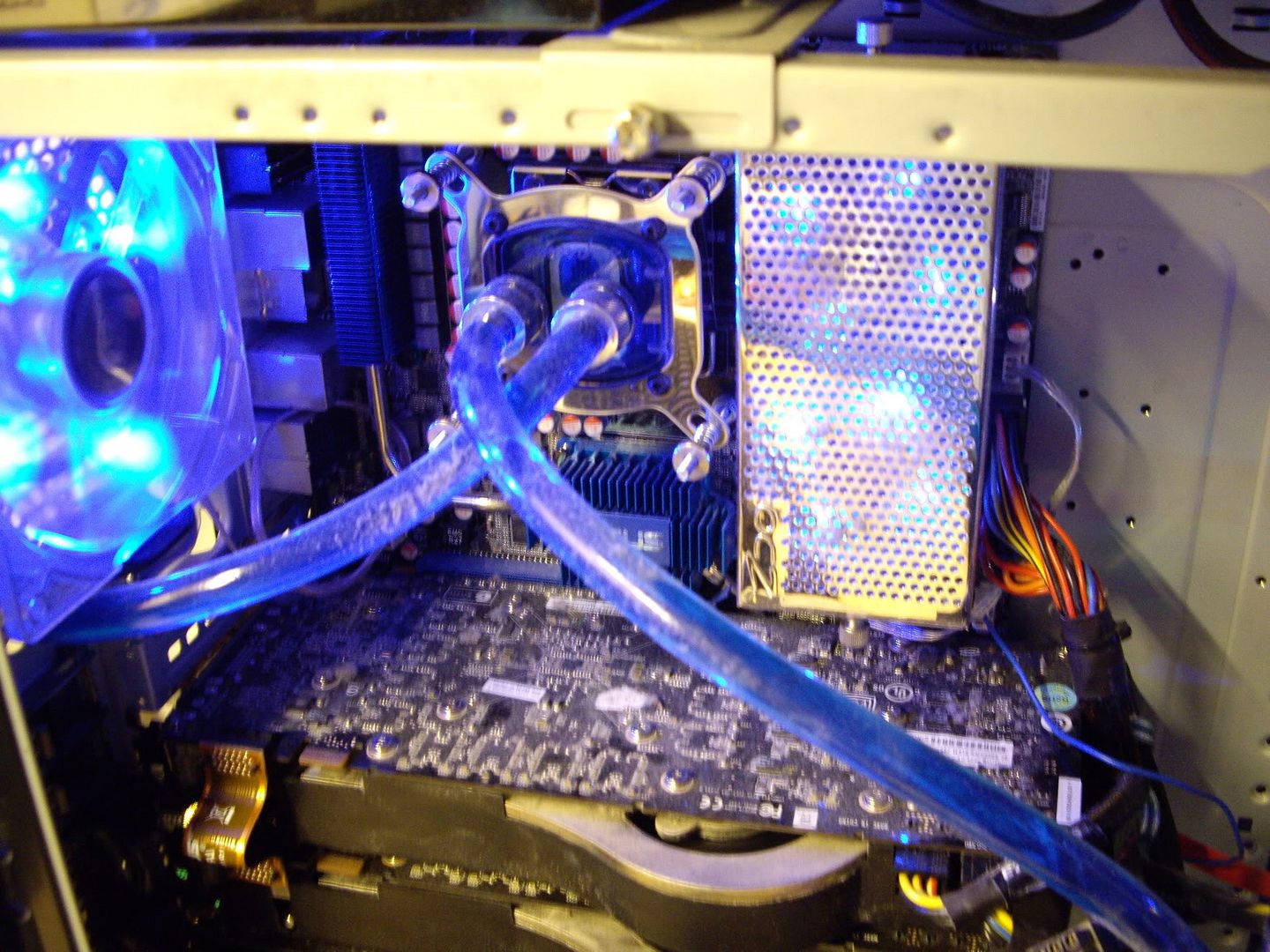

Heres the new pictures as Harry pointed out that i was too lazy.
Radiator
CPU Block
PUMP and Reservoir
