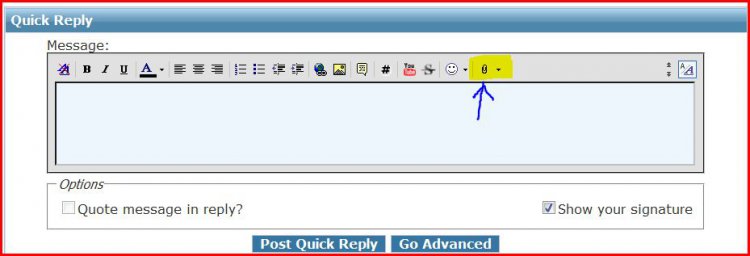

OK, we need you to upload the log to us.
Go to Computer C:Windows,logs,cbs.
Right click and send to compressed (zip)folder and save it to your desktop
On your next post click on the paperclip and browse to the desktop saved file.
Click upload and wait for it to finish uploading then close the window.
I will ask someone to look at it for you.

here it is mate.
