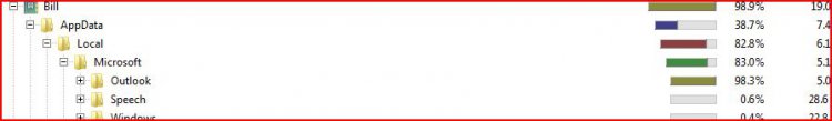

See if this helps.

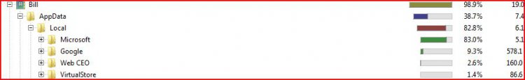

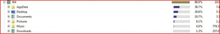

If users per windirstat shows nothing unusual,
TFC does not clean out the junk

Use Windistat. Take shots of the way it is now. Then compare if HD shrinks.
