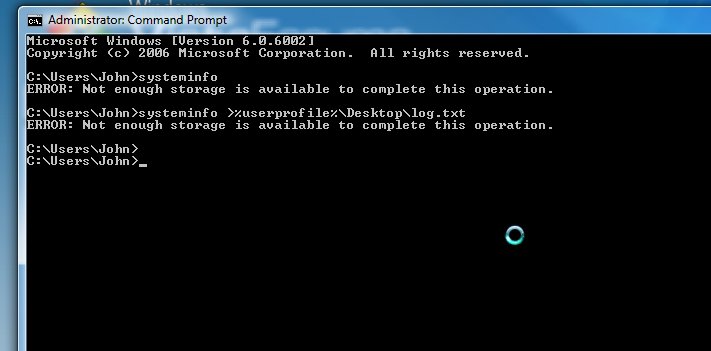

Run cmd.exe and type:
systeminfo >%userprofile%\Desktop\log.txt
On your desktop appear log.txt file ->attache this file to post
Even get the message from the command line. See attachment.
BTW, there is a "log.txt" file on my desktop, but it is empty.

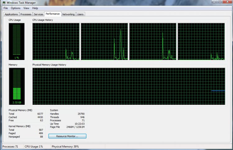

Here you go.
Again, thanks for the help.
JP
