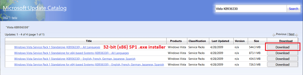

If you have a 32-bit Italian version of Vista then be sure to download the "All Languages" .exe installers for Service Pack 1 and/or Service Pack 2.

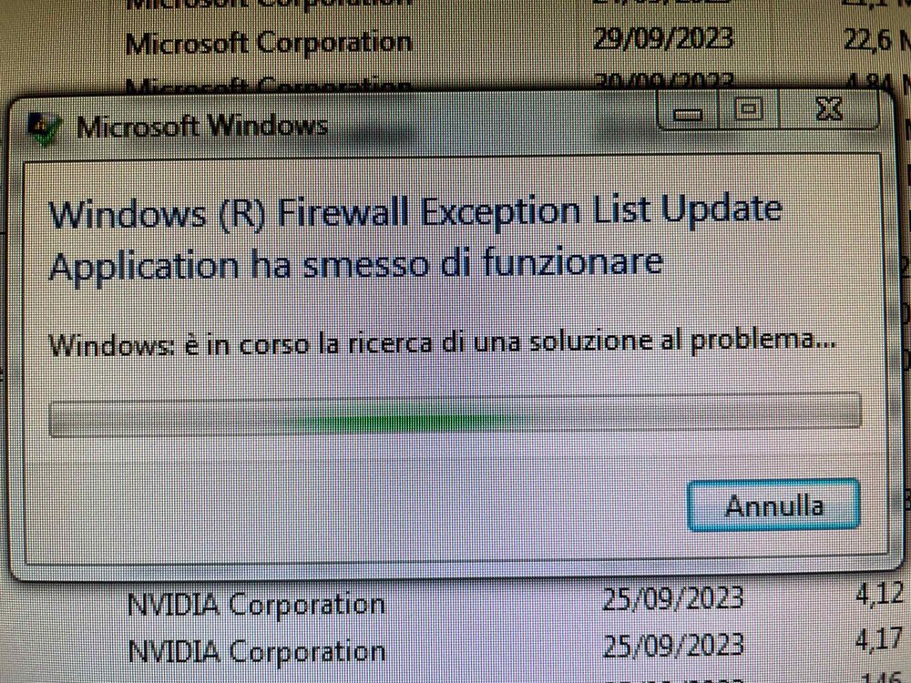

Forgive me I was actually inaccurate.
I had no problem installing SP1 and SP2 and the Microsoft .NET Framework v3.5.
The problem with the game occurs during the installation and concerns not accessing the firewall rule setting and I think it is probably due to the fact that I do not have all the updates installed.

Civilizazion IV
this is the error that apperas when I installa and unistall the game
"windows firewall exceptions list update application has stopped"
then when I try lunch the game, after double-clicking on the icon nothing happens
for the moment, I tried install only this game
    WIndows Vista Home Premium 32bit
    Acer Aspire M5641
The problem with the game occurs during the installation and concerns not accessing the firewall rule setting and I think it is probably due to the fact that I do not have all the updates installed....

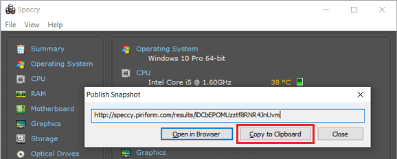

It might be helpful if you published a Speccy diagnostic so we can see some basic information about your system configuration. To use Speccy:
  1. Download the portable version of Piriform's free Speccy v1.32 utility (spsetup132.zip) available <here>, save the file to any location, and unzip.**
  2. Double-click the appropriate .exe file to launch the program (Speccy.exe for your 32-bit OS; Speccy64.exe for a 64-bit OS) and allow it to populate the interface with information about your system software and hardware.
  3. Go to File | Publish Snapshot and copy and paste the URL this generates (e.g., http: // speccy.piriform.com/results/xxx... as shown in the image below) in your next reply.
** You can run Speccy Portable from any location, including a removable USB thumb drive. If you can't download and unzip the spsetup132.zip file on your problem Vista SP2 computer then plug a USB thumb drive into another working computer, save and unzip the spsetup132.zip file on that USB thumb drive, and then remove that USB thumb drive and plug it into your problem Vista SP2 machine.

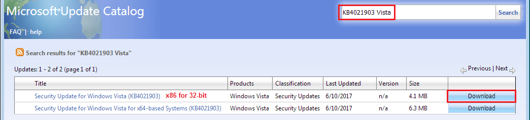

To install these .msu security updates:
  1. Disable automatic Windows Updates [Windows Update | Change settings | Important updates | Never check for updates (not recommended)] and re-boot to terminate any Windows Update session currently running in the background. ***
  2. Download the offline .msu installers from the Microsoft Update Catalog and save them to your Windows desktop. Use the Vista x86 installer if you have a 32-bit OS; use the Vista x64 installer if you have a 64-bit OS (see image below).
  3. Double-click each .msu file on your desktop to start the installation. You do not need to restart your computer after each installer is finished unless you are prompted to do so.
  4. Restart your computer.
*** IMPORTANT: Leave your automatic Windows Updates disabled. Microsoft deactivated the Windows Update servers on August 3, 2020 for computers with unsupported Windows operating systems like Win XP SP3 and Vista SP2 that do not support SHA-2 code signing - see the Microsoft support article Windows Update SHA-1 Based Endpoints Discontinued for Older Windows Devices for more information. Running Windows Update on a Win XP or Vista machine after August 3, 2020 will now throw an error message, and running automatic background checks for Windows updates will only waste system resources and may cause other problems like slow system performance or system freezes.
