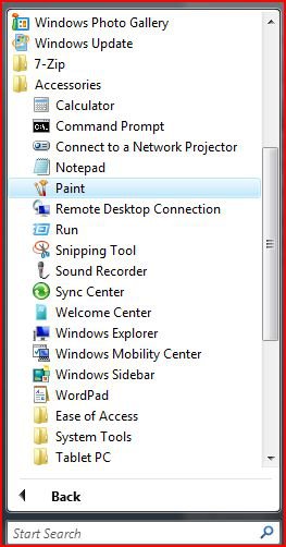

Get the DM screen shot without trying the FR, could you be able to abort FR and start the system as normal?
To get the snip, start-> all programs-> Accessories.
EDIT: I just want to see your hidden partition is intact, if it is you could also try Factory Restore by pressing Alt+F10 buttons at the same time without using the disks you created.

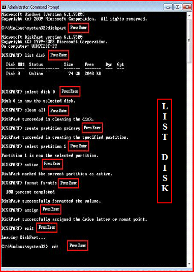

Type in command line
If you have no partitions on your HD.
DISKPART
LIST DISK
SELECT DISK # (win HD)
CLEAN ALL
CREATE PARTITION PRIMARY
SELECT PARTITION 1
ACTIVE
FORMAT fs=NTFS
ASSIGN
EXIT
EXIT

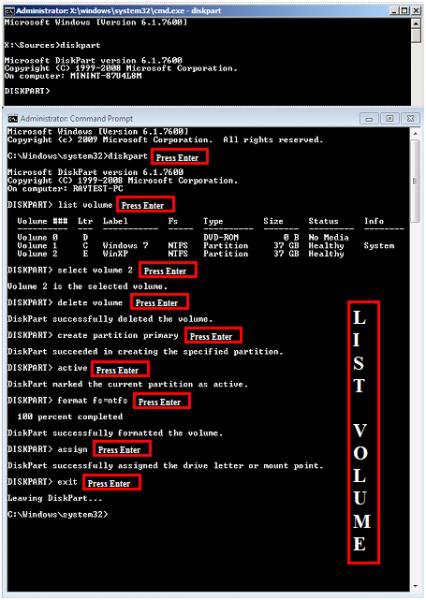

If you have partitions on your HD.
DISKPART
List Volume
SELECT VOLUME # (win VOLUME)
DELETE VOLUME
ACTIVE
FORMAT fs=NTFS
ASSIGN
EXIT
EXIT
