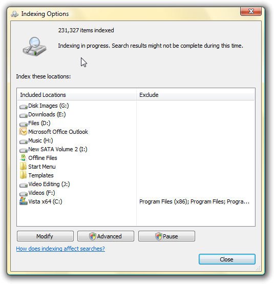

1. Open Control Panel
If you are using the default view of Control Panel, do the following:
A) Click On "System and Maintenance"
B) Click on "Indexing Options"
Or, if you are using the classic view Control Panel, locate and double-click the "Indexing Options" icon

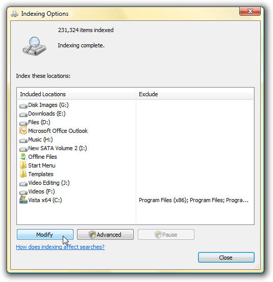

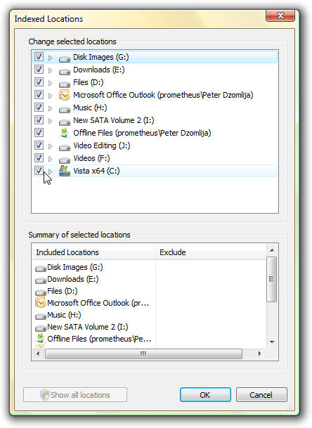

2. Click the "Modify" button:
3. Click the "Show all locations" button. You will need to respond to a UAC prompt.
4. In the Indexed Locations window, you can modify which items will be included in the index by adding or removing the check marks for any given item. For best results though, it is best to check all available locations:
5. Click "OK".
Because the indexing service will operate substantially slower while you are using the computer, you should leave the computer on for several hours so that indexing can complete quicker. Overnight is usually a good idea.
If you have made substantial changes to the Indexing settings, you may at this point want to follow the procedures in Step Two below so that the indexer can properly rebuild it's database from the start.
6. When indexing is complete, click the "Close" button.

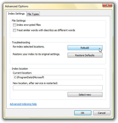

2. Click the "Advanced" button. You will need to respond to a UAC prompt.
3. Click the "Rebuild" button:
4. You will be prompted "Are you sure you want to rebuild the index?". Click "OK" to rebuild the index, or "Cancel" to exit.

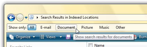

Show Only
You can filter the search to show All items, E-Mail, Documents, Pictures, Music or Other items by clicking the relevant filter at the top of the search window:

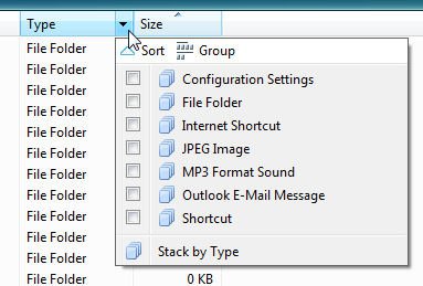

Column Headings
A hidden drop-down arrow will be made visible when you hover the mouse over the right edge of a header in Search Results. Clicking this arrow will present you with 3 global options, and a list of check boxes that varies depending on which header you clicked. The three global options are "Sort", "Group" and "Stack By".
If a particular column header that you want to use is not visible, then do the following:
A) Right-click on the headers and select the "More..." command
B) You can then show or hide whatever headers you want by adding or removing check marks from the items you want
C) Click "OK"
Note: Using the Column Headings to filter search results works in standard Windows Explorer views as well. You can use these techniques to filter a folder view to show only a subset of the files it contains:
1. Sort
Clicking this command will sort the given search results. Clicking Sort again will reverse the results. The header currently being used for sorting is highlighted in a different color from the rest of the headers, with an arrow in the middle indicating the direction of the sort.
Using the Sort command will also stop grouping of results.

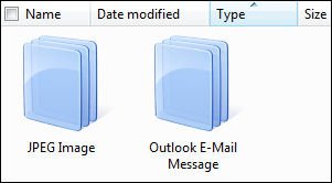

2. Group
Clicking the Group command for any particular header will convienently group the results for you to make it easier to locate similar items. Each group will be labelled with the appropriate text, and will also include in brackets the number of items contained in that group. There are a number of actions that can be performed with groups:
A) Clicking a group label will select all items in that group​
B) Clicking the arrow on the right-side of a group label will collapse or expand that group
C) Right-clicking on any group label will open a popup menu from which you can select the "Expand all groups" or "Collapse all groups" commands. Particularly if you have a lot of results to browse through, it is great being able to collapse all groups to make it easier to find the group you want. You can then click it's arrow to expand it again to reveal the items in that group.

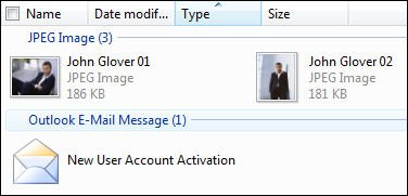

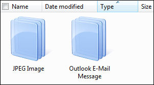

3. Stack By
The Stack By command is very similar to groups, except that the results are filtered down to single icons according to the header you clicked. To view the items contained in any given "stack", you need to double click it's icon. To return to the stack icons, click the Back button:
Using the stacks system is useful if you're only interested in a single group of items, and you want to filter down your search results to only those items.
