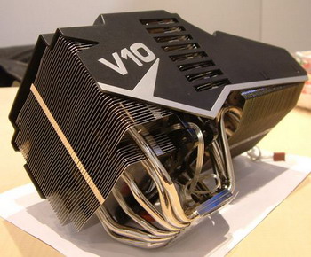

um............ look into the coolermaster v10.... or something along that line... i think its nautica that makes cpu coolers they have some good ones
lol.....if he's got trouble fitting the Zalman 9500, i dont think this monster will be much better...:eek::p
its not a very good cooler IMO, i'd look at ''scythe'' coolers, they've got some great heat sinks...;)
