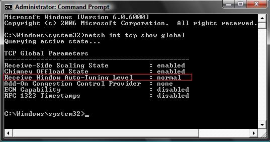

FIRST
How To See Current Auto Tuning Settings
2. Click on Continue in the UAC prompt.​
3. In the command prompt, type in bold belowand press Enter. (See screenshot below)​
netsh interface tcp show global
4. Close the command prompt when done.​
5. Run through the steps below to see if you have a TCP/IP Auto Tuning issue​

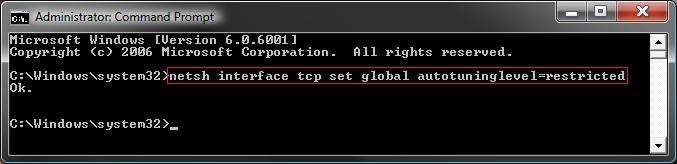

How to Restrict Auto Tuning
3. To Restrict Auto Tuning
NOTE: Allows for the receive window to grow beyond the default value of 65,535 bytes, but limits such growth in some scenarios.​
A) In command prompt, type in bold below and press Enter. (See screenshot below)​
netsh interface tcp set global autotuninglevel=restricted
B) You will get a OK response if successful. If not, repeat step 3A.​
C) Go to step 5.​

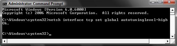

4. To Highly Restrict Auto Tuning
NOTE: Allows for the receive window to grow beyond the default value of 65,535 bytes, but doing so very conservatively. In this mode, Vista will by default use a RWIN of 16,384 bytes with a scale factor of 2.​
A) In the command prompt, type in bold below and press Enter. (See screenshot below)​
netsh interface tcp set global autotuninglevel=high
B) You will get a OK response if successful. If not, repeat step 4A.​
5. Close the command prompt window and restart the computer to apply the changes.​
6. If it fixed your problem stop here. If not, continue to Step Two below.​

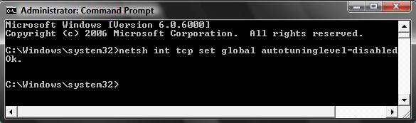

STEP TWO
How to Disable Auto Tuning
NOTE: Disables the autotunning feature in Vista completely, and sets and locks the RWIN receive window to the default value as 65536 bytes.
netsh interface tcp set global autotuninglevel=disabled
You can also type in bold below and press enter after each command:
  • netsh
  • interface
  • tcp
  • set heuristics disabled
  • set global autotuninglevel=disabled
  • exit
4. You will get a OK response. If not, repeat step 3.​
5. Close the command prompt and restart the computer to apply the changes.​
6. If it fixed your problem stop here. If not, you may not have a issue with Auto Tuning and will need to turn it back on. Continue to Step 3 below.​

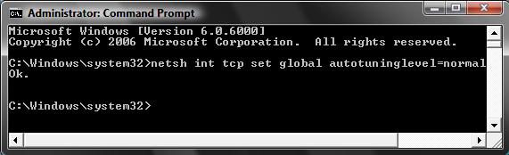

STEP THREE
How to Enable Auto Tuning Back to Normal Default
NOTE: This turns Auto Tuning back to the default on (Normal) setting in Vista. Allows for the receive window to grow to accommodate almost all scenarios. See NOTE at the top of the tutorial for more on this.
3. In the command prompt, type in bold below and press Enter. (See screenshot below)​
netsh interface tcp set global autotuninglevel=normal
  • netsh
  • interface
  • tcp
  • set heuristics enabled
  • set global autotuninglevel=normal
  • exit
4. You will get a OK response if successful. If not, repeat step 3.​
