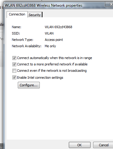

Try going to network and sharing center => manage wireliss networks => adapter properties => configure => power management => uncheck "Allow the computer to turn off this device to save power"
