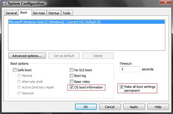

3. Click on the Boot tab. (See screenshot below)
4. To See OS Boot Information
A) Check OS boot information. (See screenshot below step 7)
B) Go to step 6.
5. To Restore Normal OS Boot
A) Uncheck OS boot information. (See screenshot below step 6)
6. Check the Make all boot settings permanent box, and click on Apply.

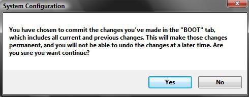

7. Click on Yes at the confirmation window. You will be able to change this back. (See screenshot below)
8. Restart the computer to see the boot information.
