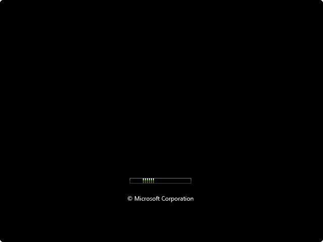

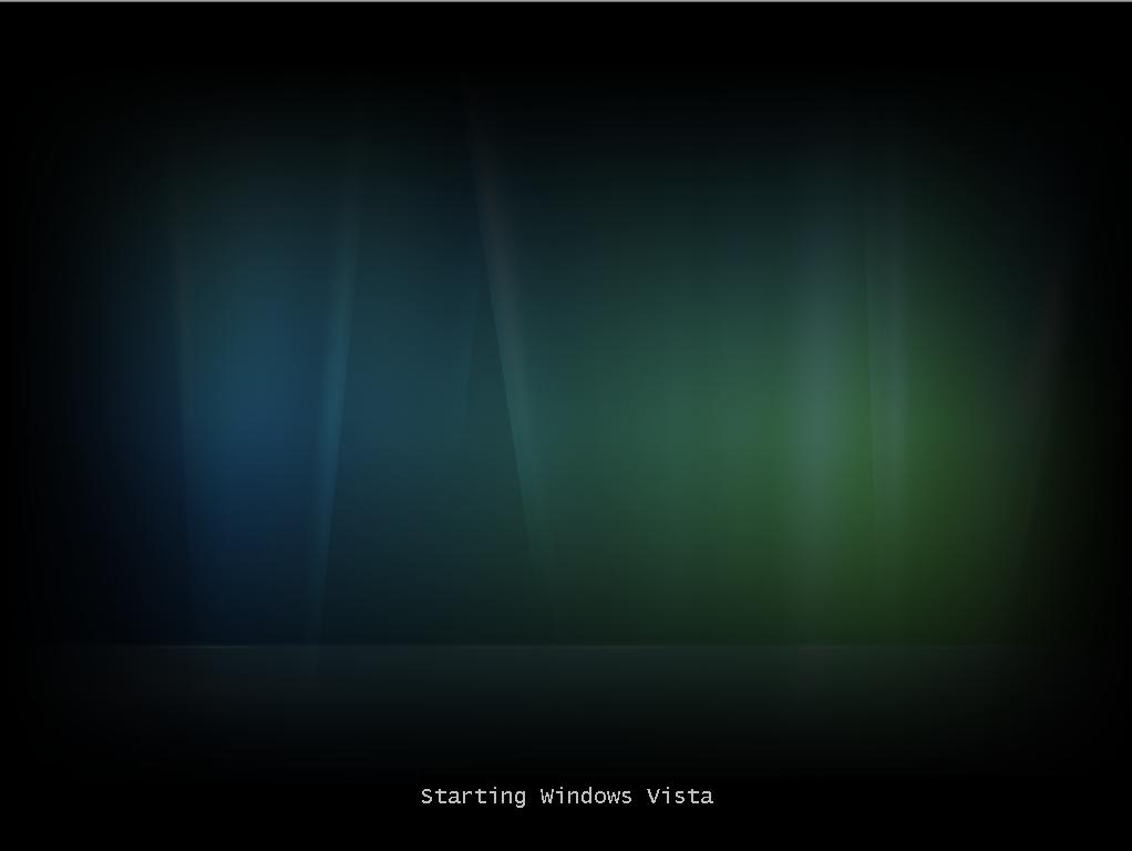

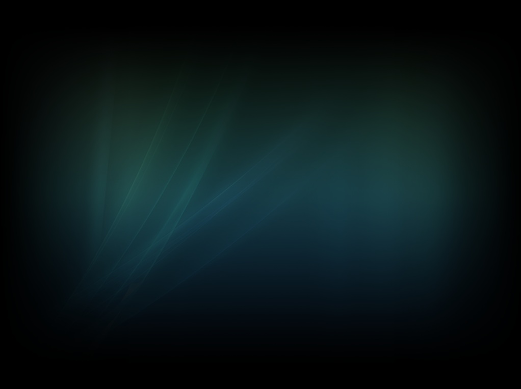

EXAMPLE: Default Vista boot screen

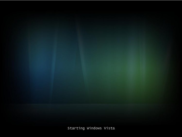

EXAMPLE: Aurora boot screen without SP1 and SP2 installed
EXAMPLE: Aurora boot screen with SP1 installed
EXAMPLE: Aurora boot screen with SP2 installed

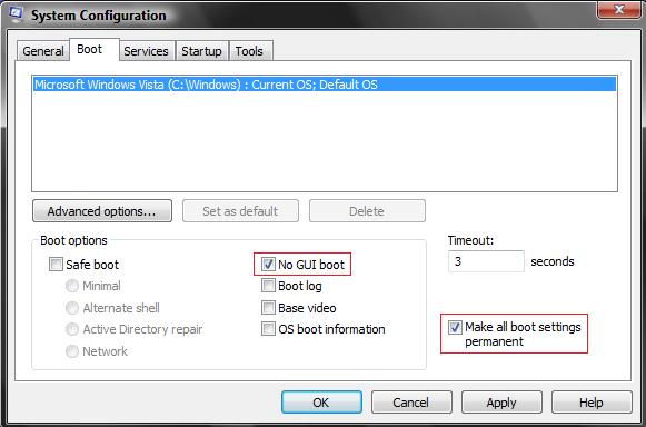

1. Open the Start Menu.​
2. In the white line (Start Search) area, type msconfig and press Enter.​
4. Click on the Boot tab. (See screenshot below step 8)​
5. To Enable the Aurora Boot Screen
A) Check the No GUI boot box. (See screenshot below step 8)​
B) Go to step 7.​
6. To Go Back to the Default Boot Screen
A) Uncheck the No GUI boot box. (See screenshot below​
step 8)​
7. Check the Make all boot settings permanent box.​
8. Click on OK.​

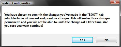

9. Click on Yes to the confirmation window. You will be able to change it again. (See screenshot below)​

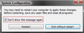

NOTE: If you checked the Don't show this message again box and want to restore this restart notice, then see: How to Restore the System Configuration Restart Prompt in Vista
11. You will now see the new hidden Aurora boot screen after the restart and during startup.​

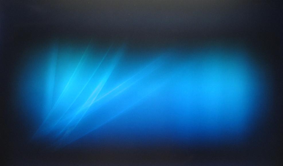

Do we know how to change the Aura Screen when windows is resuming from hibernation/sleep? Id like to make that custom too seeing as the Aura screen is ugly on a 17" widescreen lol

right now ive got a custom boot screen looks great when turning on first time, but when i close the lid it goes to sleep/hibernate then when i reopen it, it resumes windows and shows the Aura screen saying "resuming windows" then after that loads to desktop, just not sure where that aura screen is comming from so i can change it.
( 9 mins later) Editing post, becasue I attempted to do the same thing to the winresume.exe.mui file by using a copy of the boot screen ive got working only renamed to match, closed lid, resumed, same thing, got the Aura screen saying "resuming windows" with the green bar on the bottom

This is a normal part of the hibernation process. When Vista wakes up from hibernation, this is the screen that will show as it first starts up and loads memory back from disk. I do not know of a way to change this screen yet though.

it appears that in SP1, the aurora image has been changed to the same flare used in the “resume from hibernation” splash, with the text “Starting Windows Vista” also removed. This flare is far more consistent with the background image presented during log-in.
