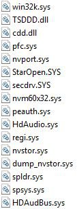

You also have some very outdated drivers (2002, 2005, 2006, 2007, lost time stamp)
These should also be investigated and updated.
