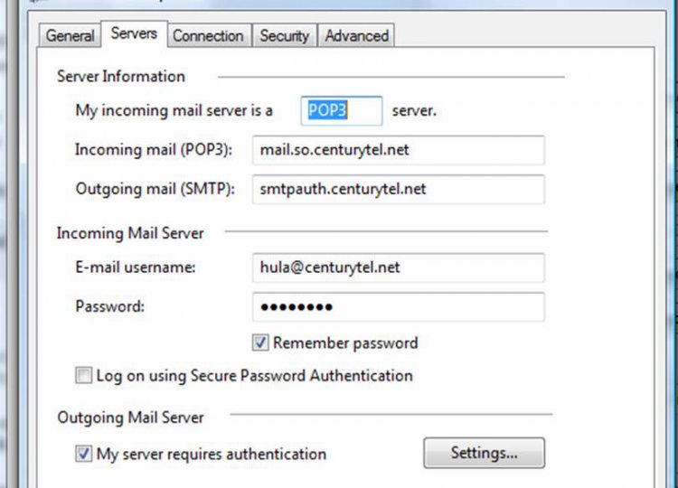

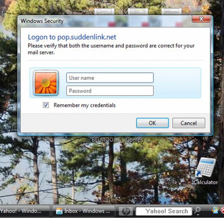

shula
Messages
1
#15
I use windows Mail. Vista home prem 32. I use Centurytel at work and Suddenlink at home. I can send get mail at home (Suddenlink ISP) but canot send. Before I got laptop with Vista, I could send & recive from work & home no probelm. I have set up a new email address using the sudden link settings. When I open my Windows email, my mail comes in, but a box pops up asking me for my Suddenlink Login & Password. This is my wife's acct and she has given me every password she has but it will not take any of them? Suddenlink nor Cnturytel will help me reslove the issue and say it is a Microsoft Windows Mail issue ... Pictures attached.
