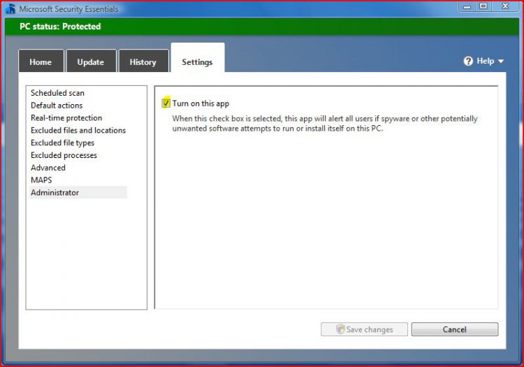

Otherwise, your best solution is to turn off MSE in safe mode, which would enable you to log in normally again. You could then uninstall either MSE 4.9 or your other antivirus program. It's very easy to turn off MSE 4.9 using the new Administrator setting in the user interface. Simply open MSE, click the Settings tab, select Administrator and uncheck Turn on this app. Edit: Then be sure to click Save changes. Here's a screenshot:

Otherwise, your best solution is to turn off MSE in safe mode, which would enable you to log in normally again. You could then uninstall either MSE 4.9 or your other antivirus program. It's very easy to turn off MSE 4.9 using the new Administrator setting in the user interface. Simply open MSE, click the Settings tab, select Administrator and uncheck Turn on this app. Here's a screenshot:

You can manually create new restore points, but I don't believe you can manually create old ones. You are the first person to report the black screen persisting after disabling MSE, causing me to wonder if my instructions were insufficient. After unticking/deselecting "Turn on this app" (see screenshot), did you click "Save changes" at the bottom of the window? If that really does not work for you, I saw one report that MSE can be uninstalled in safe mode using Revo, but I certainly never tried it myself.
