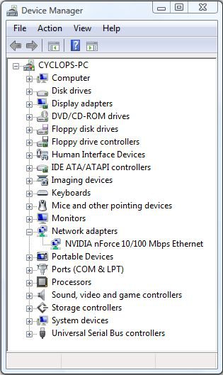

Hi chesee48 and welcome to Vista Forums :party:
Although people have had issues with D-Link routers, I think that we can possibly eliminate that here since you tried connecting through it and connecting directly to your modem. Instead, I think that it could be a driver issue. To check this, click on the start orb and type Device Manager into the search box and press enter/return. Click OK when the warning message appears and then click on Network adapters to expand that section.
Do you see a yellow warning triangle or a red cross here (or, indeed, any of the other categories)? Please reply with this information, and also with the make and model number of your computer. Please also state whether you have 32-bit or 64-bit Vista installed.

No such luck. No yellow triangle or red cross on any categories...it is a 64bit
HP E5200
