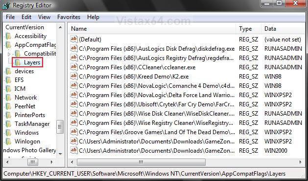

4. In regedit, go to: (See screenshot below step 5)
Code:
HKEY_CURRENT_USER\Software\Microsoft\Windows NT\CurrentVersion\AppCompatFlags\Layers
5. To Have a Program Run in Compatibility Mode
A) In the right pane, right click on a empty area and click on New, then on String Value. (See screenshot below table)
C) Type in the full path of the program's exe file and press Enter.
D) In the right pane, right click on the full path and click Modify.
E) Type in a Compatibility Mode Data value (see table below) you want below, and click on OK.

6. To Remove a Program from Running in Compatibility Mode
A) In the right pane, right click on the full path Name and click on Delete. (See screenshot above)
B) Click on Yes to confirm the deletion.
