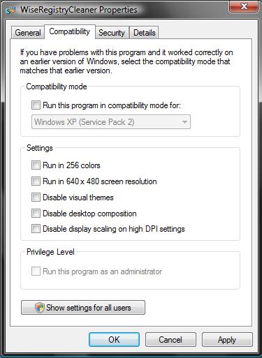

1. Right click on the program's shortcut, .exe file, or installation program.​
2. Click on Properties.​
3. Click on the Compatibility tab.​
NOTE: If these options are grayed out, then you may be able to put the program in compatiblilty mode by adding it manually to the list.
4. To Have the Program Run in Compatibility Mode
A) Check the Run this program in compatibility mode for box. (See screenshot below)​
B) Continue to step 5.​
5. Settings Section
NOTE: On some older applications, it may be necessary to select and try different combinations of these display setting options if the application still does not quite run properly. (See the screenshot above).​

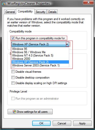

6. To Select or Change a Compatibility Mode for the Program
A) Click on the drop down menu arrow and select which version of Windows the program was made for. (See screenshot below step 10)​
NOTE: Always pick the latest Windows version the program was made for to have a better chance of it running in Vista.
B) Go to Step 8.​

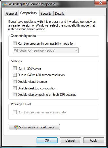

8. To Have the Program Run as Administrator
NOTE: On some older programs and installation files, it may be required for them to Run as administrator for it run properly. This is usually due to the fact that the older program was not designed for the UAC permission approval in Vista. Test running the program without using this first.​
A) Check the Run this program as an administrator box. (See screenshot below step 10)​
B) Go to step 10.​
9. To Stop the Program from Running as Administrator
A) Uncheck the Run this program as an administrator box. (See screenshot below step 10)​
10. Click on OK to apply and close window.​
11. Now try and run the program to see if it will run properly.​
NOTE: If it does not run properly, then try another compatibility mode setting.​

Hi Shawn,
In addition to the information in your tutorial, it may also be necessary to try enabling and disabling various combinations of the options under the 'Settings' section if a program doesn't quite run correctly.
