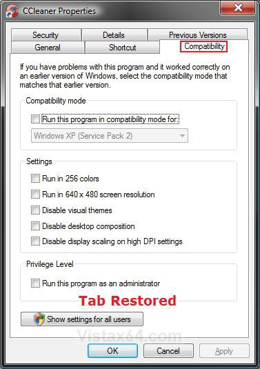

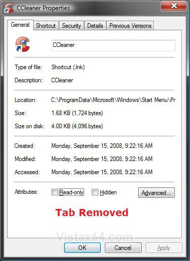

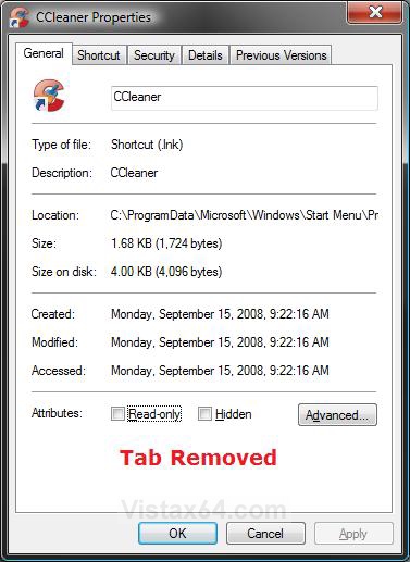

EXAMPLE: Compatibility tab Before and After removed from Properties

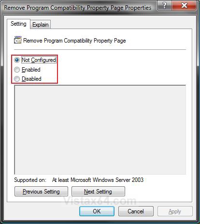

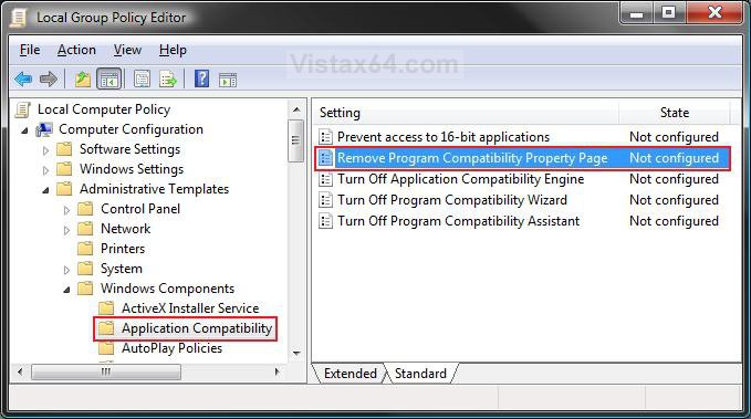

Through Local Group Policy Editor
2. In the left pane, click on Computer Configuration, Administrative Templates, Windows Components, and Application Compatibility. (See screenshot below)​
3. In the right pane, right click on Remove Program Compatibility Property Page and click on Properties. (See screenshot above)​
4. To Restore the Compatiblity Tab
B) Go to step 6.​
5. To Remove the Compatiblity Tab -

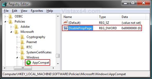

Manually in Registry Editor
1. Open the Start Menu, then type regedit in the search box and press Enter.​
2. If promped by UAC, then click on Continue (Vista) or Yes (Windows 7).​

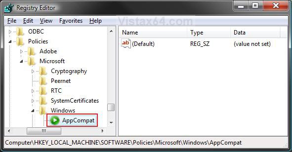

3. In regedit, navigate to the location below. (See screenshot below)​
NOTE: If AppCompat is not there, then right click on Windows and click on New and Key. Type AppCompat and press Enter.​
HKEY_LOCAL_MACHINE\SOFTWARE\Policies\Microsoft\Windows\AppCompat
4. To Remove the Compatiblity Tab

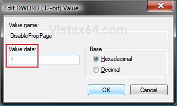

A) In the right pane, right click on a empty area and click on New and DWORD (32-bit) Value. (See screenshot above)​
B) Type DisablePropPage and press Enter. (See screenshot below)​
C) Right click on DisablePropPage and click on Modify.​
F) Go to step 6.​
5. To Restore the Compatiblity Tab
A) In the right pane, right click on DisablePropPage and click on Delete. (See screenshot above)​
B) Click on Yes to confirm the deletion.​
