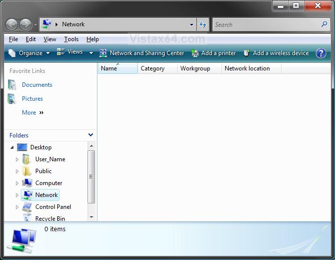

EXAMPLE: Network window
NOTE:
This is where your computer name will be hidden or unhidden from displaying in the other computers on the same network.

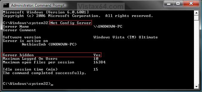

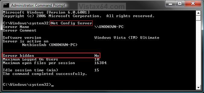

2. To Verify and See if your Computer Name is Hidden or Unhidden
A) In the command prompt, type Net Config Server and press Enter. (See screenshots below)​
B) If it is hidden, then you will see Yes to the right of Server hidden. (See top screenshot below)​
C) If it is unhidden, then you will see No to the right of Server hidden. (See bottom screenshot below)​
D) Go to step 3 or 4.​

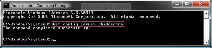

4. To Unhide your Computer Name to Display in Network
A) In the elevated command prompt, type in bold below and press Enter. (See screenshot below)​
Net config server /hidden:no
B) You will get a The command completed successfully message afterwards.​

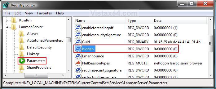

4. In regedit, go to: (See screenshot below step 5)​
HKEY_LOCAL_MACHINE\SYSTEM\CurrentControlSet\Services\LanmanServer\Parameters
5. In the right pane, right click on hidden and click on Modify.​
NOTE: If hidden is not here, then in the right pane, right click on a empty area and click on New and DWORD (32-bit) Value and type hidden and press Enter.​
6. To Unhide your Computer Name to Display in Network
A) Type 0 (number zero) and click on OK or press Enter. (See screenshot below step 7)​
NOTE: The registry should look like the screenshot above for unhidden.​

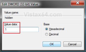

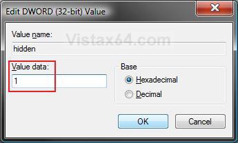

7. To Hide your Computer Name from Displaying in Network
A) Type 1 (number zero) and click on OK or press Enter.​
B) The registry will now look like this for hidden. (See screenshot below)​
