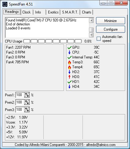

I don't know which of the temperatures given by SpeedFan is the one you're after, not that I really want to be stressing the CPU too much given that it's overheating as-is.
Please post a screenshot of speedfan. That will help.

The thing that bothers me is that Fan 2, apparently for your CPU, is shown as not running. Can you verify that. On further review, I think I read SpeedFan incorrectly.

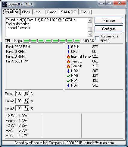

I set up and started the encode that was running when my computer overheated. It's come down from about 40 hours to around 17, although that still seems a little high. Took a SpeedFan screenshot:
From what I can find, Tcase for the 920 is 67.6 C. I don't have time to find out how to correlate that with core temperatures but it seems that core 4 is running hot and the cpu might start shutting down cores. As I mentioned before, there may be a thermal paste issue but I'm not a qualified technician.
