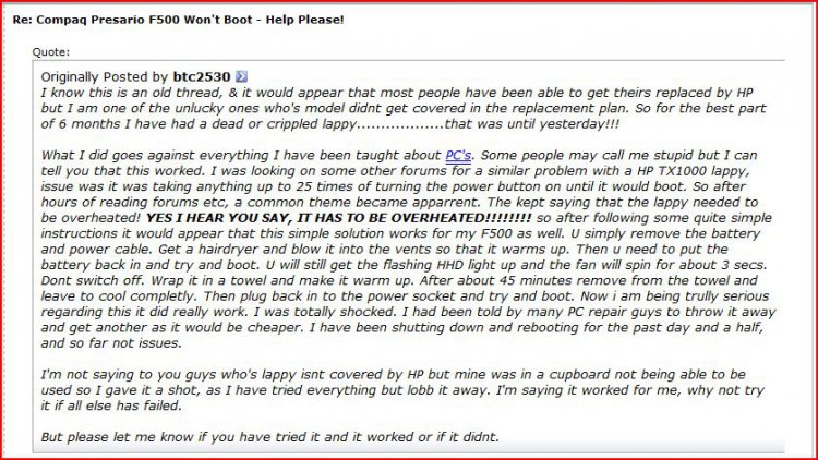

Hi Rich,apparently HP compac presario f500 has been having a lot of problems with this complaint, that they extended the warranty an extra two years, they would replce the motherboard, this was purchased in 2007 and HP's reply your out of luck, So i googled (compac presario wont boot) and it brought me to a forum site where a lot of other people where having the same problem, and one of the suggestions was to use a hair drier, Well my first impression was this guy has lost his marbles, (See instructions in attachment) But this morning i thought i would give it a go, as my only alternative was to replace the motherboard, And low and behold it worked what a pleasant surprise, Another suggestion was to remove the motherboard, and remove any tape and such that might melt and place in an oven at 375% for about seven minutes Apparently its a problem with the solder, well i have had it running all day with no problems, Patch41
see attachment
