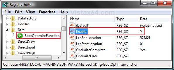

HKEY_LOCAL_MACHINE\SOFTWARE\Microsoft\Dfrg\BootOptimizeFunction

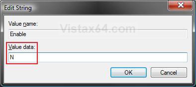

5. To Disable Defrag of Boot Files at Startup
A) In the right pane, right click on Enable and click Modify. (See screenshot above)​
B) Type N and click OK. (See screenshot below)​

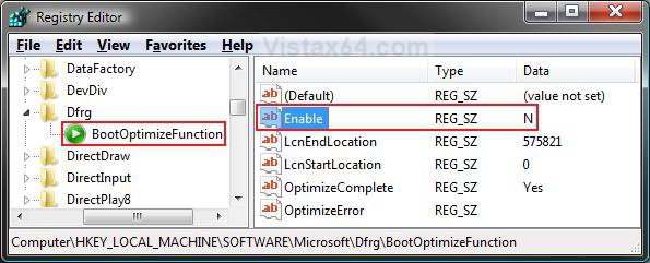

C) The registry will now look like this. (See screenshot below)​

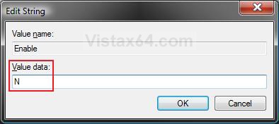

6. To Enable Defrag of Boot Files at Startup
B) Type Y and click OK. (See screenshot below)​

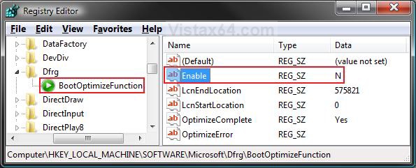

C) The registry will now look like this. (See screenshot below step 4)​

Hello. I have a little qestion. What mean's "LcnEndLocation"? In your registry entry i can seen value 575821, but in my registry is this value 0. Is this range of space in bytes of the system files on the disk or something?
Thank you in advice

Well basically LcnEndLocation stands for the "Logical Cluster Number (on the hard drive) End Location" of the files moved by Disk Defragmenter for boot optimization (defrag), and LcnStartLocation is for the start location.
The data within these cluster numbers is usually the prefetch data. The size numbers for LcnEndLocation and LcnStartLocation will vary and should not be manually modified.
