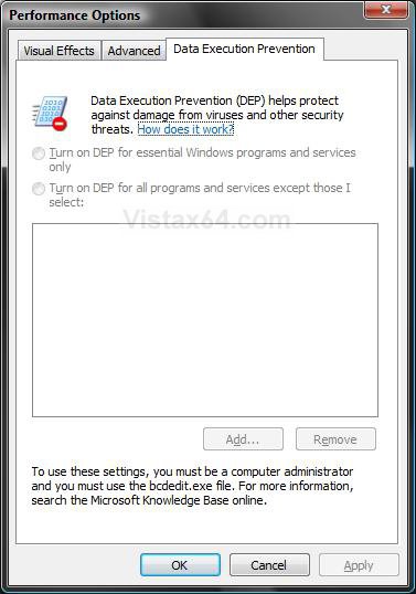

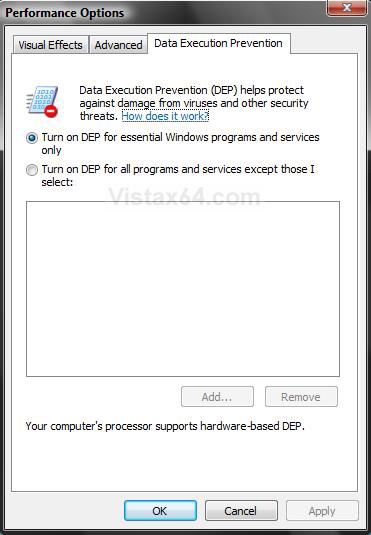

EXAMPLE: DEP Enabled and Disable
NOTE:
DEP is enabled by default. If you installed Enhanced Mitigation Experience Toolkit (EMET), then it will be used by Windows instead of DEP and gray out the DEP settings like below.

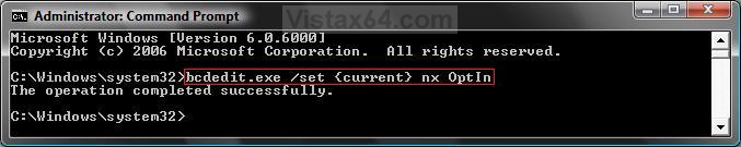

2. To Enable DEP
A) In the elevated command prompt, type in bold below and press Enter. (See screenshot below)​
NOTE: If for some reason this command does not enable DEP after restarting the computer, then use the bcdedit.exe /set {current} nx AlwaysOn command instead.​
bcdedit.exe /set {current} nx OptIn
B) You should get a success message back​
C) Close the elevated command prompt.​
D) Restart the computer to apply.​

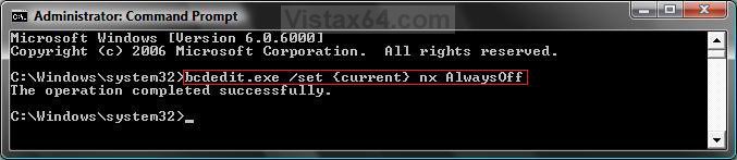

3. To Disable DEP
A) In the command prompt, type in bold belowand press Enter. (See screenshot below)
bcdedit.exe /set {current} nx AlwaysOff
B) You should get a success message back.​
C) Close the command prompt.​

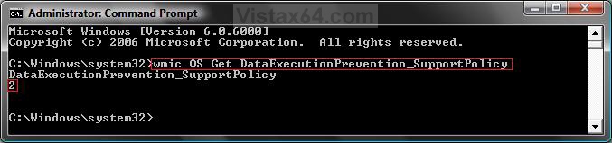

4. To Verify the Status of DEP
A) In the command prompt, type in bold below and press Enter. (See screenshot below table)​
wmic OS Get DataExecutionPrevention_SupportPolicy
B) You will get a number (see table below) that will tell you the status of DEP.​
C) Close command prompt when done.​
2 is the default setting.

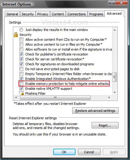

3. In Internet Explorer, click on Tools and Internet Options.​
4. Click on the Advanced tab. (See screenshot below)​
5. To Enable DEP for the 32 bit Internet Explorer
A) Under Security, check Enable memory protection to help mitigate online attacks.​
B) Go to step 7.​
6. To Disable DEP for the 32 bit Internet Explorer
A) Under Security, uncheck Enable memory protection to help mitigate online attacks.​
7. Click on OK to apply.​
