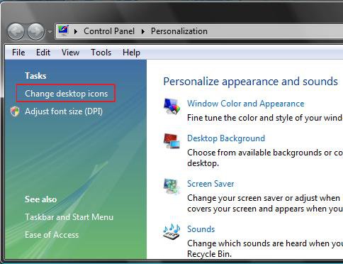

1. Right click on a empty area of the desktop and click on Personalize. (See screenshot below)​
2. Click on Change desktop icons in the upper left corner. (See screenshot below)​

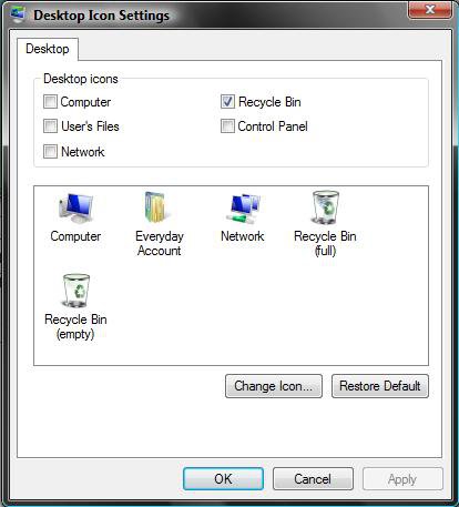

3. To Add or Remove a Destop Icon
OPTION ONE:
A) Check the Desktop icons in the top section that you want to add to the desktop. (See left screenshot below step 5)​
B) Uncheck the Desktop icons in the top section that you want to remove from the desktop.​

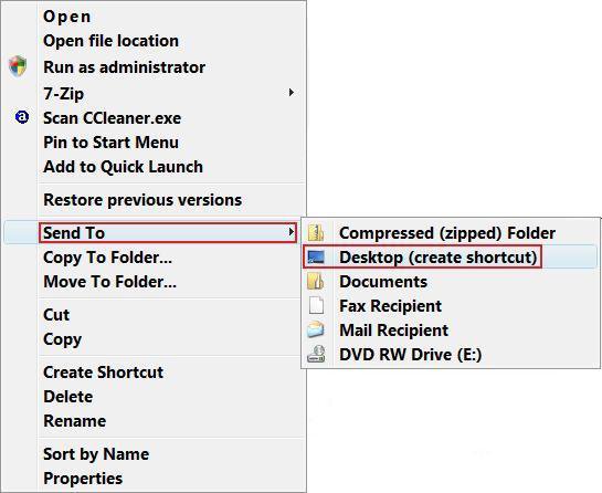

A) Right click on any file or folder.​
B) Click on Send To and Desktop (create shortcut). (See Screenshot below)​

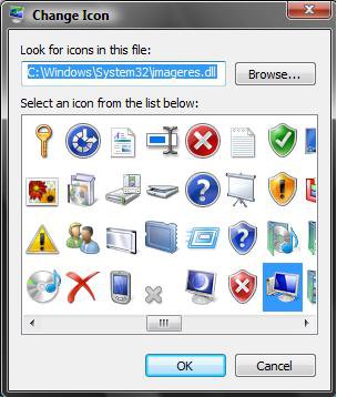

A) Click on a icon to highlight it in the middle section. (See left screenshot below step 5)​
B) Click on the Change Icon button.​
C) Select the icon you want for the desktop icon and click OK. (See right screenshot below step 5)​
NOTE: If you have a icon of your own you want to use instead, then click the Browse button and navigate to the location you saved it to. For the icon to display properly, it needs to be a 256x256 .ico icon file.​
5. To Restore the Default Icon for a Desktop Icon
NOTE: If this does not restore the default icon and you already tried manually changing the icon back in step 4, then try rebuilding the icon cache.
A) Click on a icon you want to restore in the middle section to highlight it. (See left screenshot below)​
B) Click on the Restore Default button.​
NOTE: For some reason, when you use Restore Default on the Recycle Bin, it will sometimes cause the Recycle Bin to not refresh automatically anymore. This will leave the Recycle Bin to always show as full or empty when it is not. If this happens to you, then see: How to Fix the Recycle Bin Icon Not Refreshing When Emptied
6. Click on OK to apply and close window.​

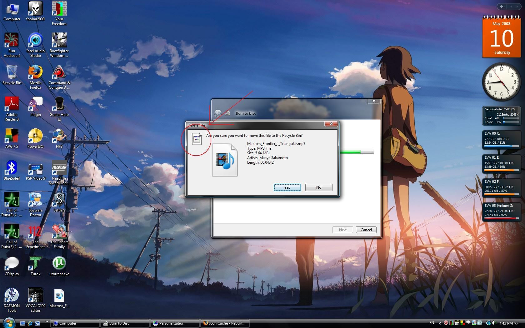

Its my first time in this forum. Im searching for my recycle bin problem(will not change to recyclebin(empty) icon when i empty the bin) solution and i end up with this forum. The solution solve my problem. Thanks. But Im still have 1 more problem. See the red circle. There is a blank icon when i want to delete an item. i already do the rebuild icon cache but still the same. Im sorry if I posting in the wrong thread.
Hi Brink,
Yeah. I already use the icon cache - Rebuild methods. The first method can't solved it. The second method, when i changed from 32bit to 16bit, the icon come back to the original. But when i changed back to 32bit, the icon become blank again..
