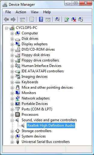

3. Under Tasks, click on Device Manager.
4. Provide administrative credentials when prompted.
5. Click on the + sign next to the device that you wish to install a driver for to expand it.

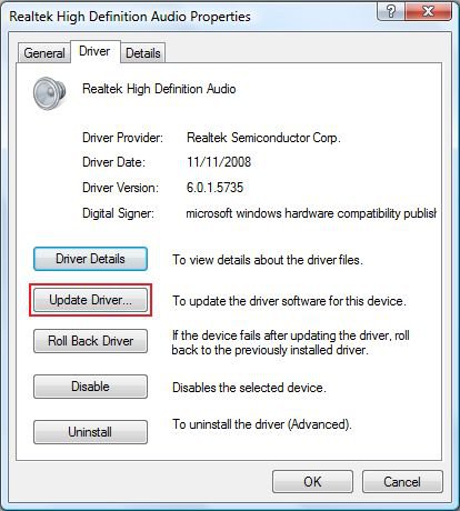

6. Right click on the selected device and click Properties.​
7. Click on the Driver tab.

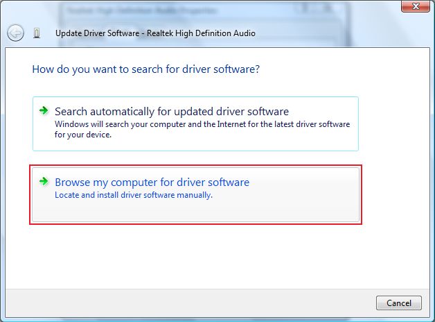

8. Click on the Update Driver... button.

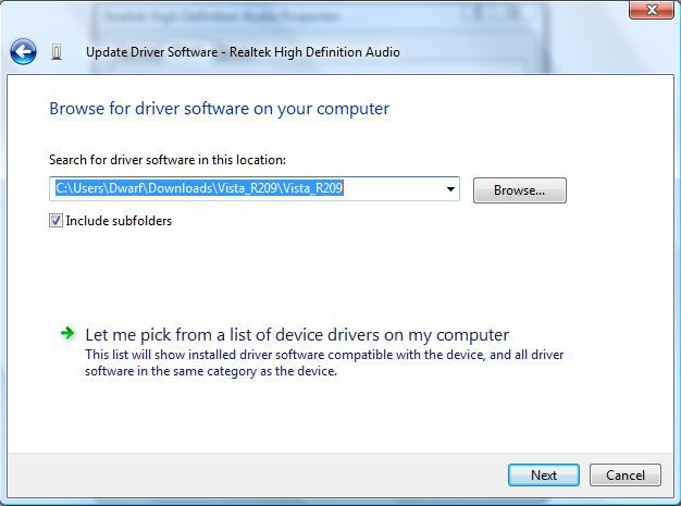

9. Click on Browse my computer for driver software.

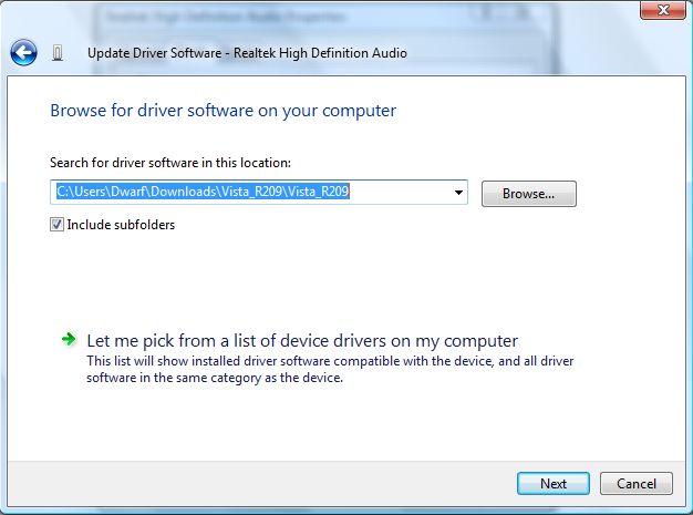

10. Click on Browse... and locate the required driver.
11. Click on Next and follow the subsequent instructions given by the installer.
