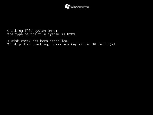

EXAMPLE: Default Disk Check (chkdsk) Startup Screen with Default 10 Seconds
EXAMPLE: Changed Disk Check (chkdsk) Startup Screen with 30 seconds

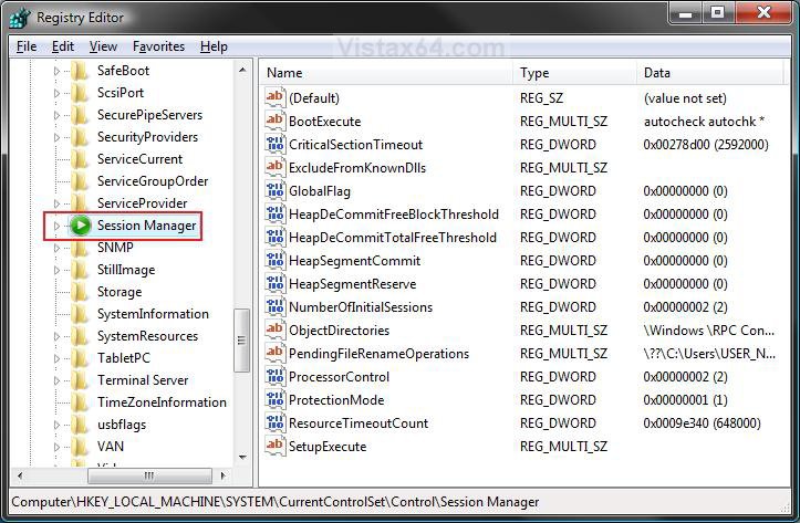

1. Open the Start Menu.​
HKEY_LOCAL_MACHINE\SYSTEM\CurrentControlSet\Control\Session Manager
5. To Change the Default Disk Check Startup Timeout Value
A) In the right pane, right click on a empty area and click on New and DWORD (32-bit) Value. (See screenshot above)​

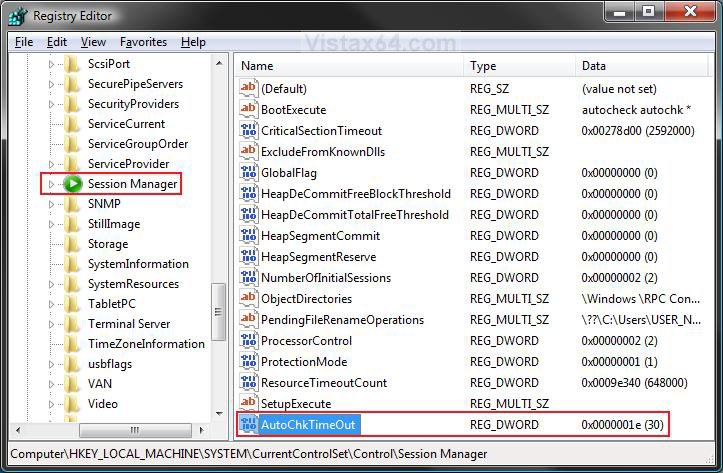

B) Type AutoChkTimeOut and press Enter. (See screenshot below)​
C) Right click on AutoChkTimeOut and click on Modify.​

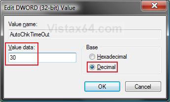

D) Dot Decimal and enter how many seconds (0 to 259,200) you want for the timeout value, then click OK. (See screenshot below)​
NOTE: Entering 0 (number zero) will give you the default 10 seconds to cancel chkdsk.​
E) The registry will now look similar to this one with 30 seconds selected. (See screenshot below)​
