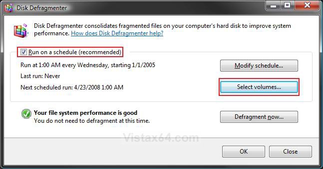

4. To Turn On the Disk Defragmenter Schedule
A) Check Run on a Schedule. (See screenshot above)
B) Go to step 6.​
5. To Turn Off the Disk Defragmenter Schedule
A) Uncheck Run on a Schedule. (See screenshot below step 2)​
B) Go to step 9.​

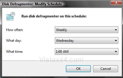

6. To Modify the Schedule Time
A) Click on the Modify Schedule button. (See screenshot below step 3)​
B) Make your time adjustments: (See screenshot below step 6C)​
  • How Often: Daily, Weekly, or Monthly
  • What Day: Pick a day, Sunday to Saturday.
  • What Time: Select a time from list.

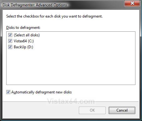

7. To Select Volumes to Defragment
NOTE: This option is only added when you install the Vista SP1.​
A) Click on the Select volumes button. (See screenshot below step 3)​
B) Check the drives you want to be included in the defrag and uncheck the drives you do not want to be included. (See screenshot below)​
C) Click on OK.​
9. To Manually Run Disk Defragmenter Now
A) Click on the Defragment now button. (See screenshot below step 3)​
B) Do steps 7B and 7A.​
NOTE: If you need to stop Disk Defragmenter, click on the Cancel defragmentation button.​
10. When done, click on OK, if it is not grayed out, or Close if it is. (See screenshot below step 3)​

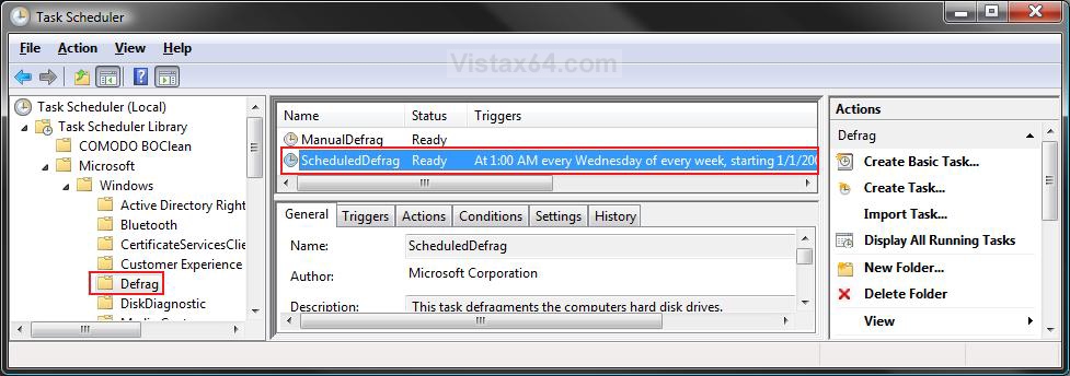

3. In the left pane, click on the arrow next to Task Scheduler Library, Microsoft, and Windows to expand the folders. (See screenshot below step 4)​
4. Click on the Defrag folder.​
5. In the middle pane right click on ScheduledDefrag and click on Properties. (See screenshot above)​

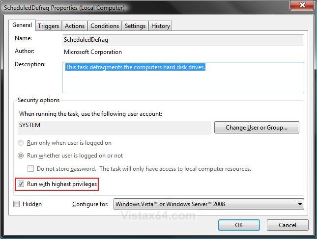

6. Click on the General tab. (See screenshot below step 7)​
7. Check the Run with highest privileges box.​

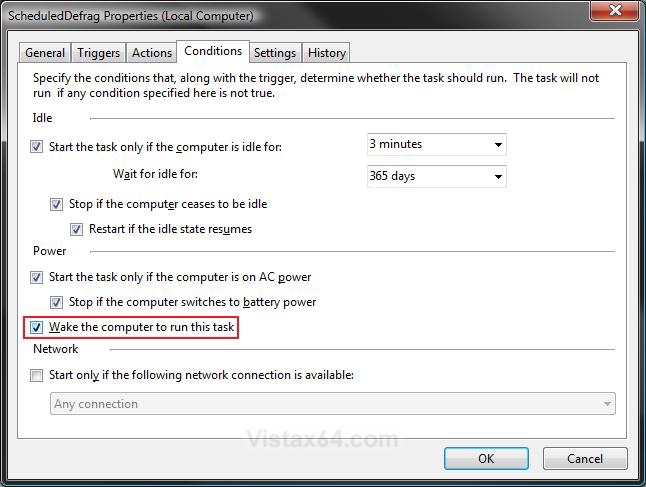

8. Click on the Conditions tab. (See screenshot below step 9)​
9. Check the Wake the computer to run this task box, and click on OK.​

In my experience (and as I have also read elsewhere), waking the computer to run defrag will not work if you set the computer to ask for a password upon waking up, correct? Do you know a way around this (without removing the password)?
Also, I was wondering if defrag will continue its job even if your computer goes to sleep?
Thanks for any help.
Hi Hannaxbear, and welcome to Vista Forums.
I have not tried it with Disk Defragmeneter, but if it will not wake the computer to run due to this, then removing the password is the only workaround that I know of. You might take a look at this to see how this works for you.
http://www.vistax64.com/tutorials/166809-task-scheduler-wake-up-computer.html
If you manually have Disk Defragmenter running, I believe the computer will not go to sleep until it has finished.
