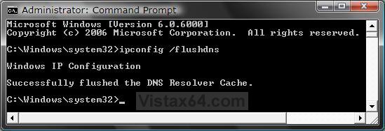

How to Flush the DNS Cache
2. In the elevated command prompt, copy and paste the command below and press Enter. (See screenshot below)​
ipconfig /flushdns
3. You will recieve the following message below if successful.​
Windows IP Configuration Successfully flushed the DNS Resolver Cache.
4. In the elevated command prompt, type the commands below and press Enter one at a time.​
net stop dnscache
net start dnscache
5. Close the elevated command prompt when done.​

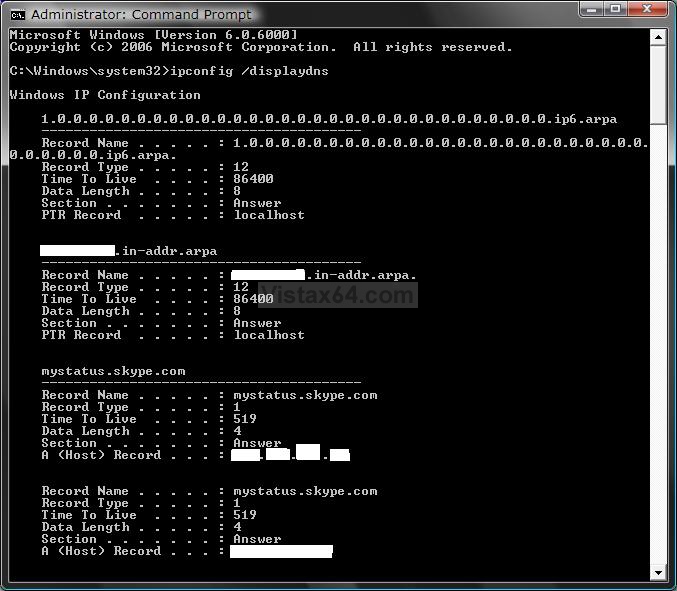

How to See the Contents of the DNS Cache
2. In the elevated command prompt, copy and paste the command belowand press Enter. (See screenshot below step 3)​
ipconfig /displaydns
3. You will now see the contents of the DNS cache.​
4. Close the elevated command prompt when done.​
