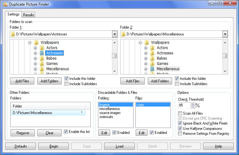

The Main Screen
When you run DPF, you will be presented with the main window, from which you can select various options prior to scanning an image library for duplicates.

Filtering Scans
The whole point of DPF is to make it easier for you to locate duplicate images. But without some form of filtering, DPF will sometimes select a file as a duplicate when you want to keep it, while preserving the file you want to delete. By default, Duplicate Picture Finder will always tag smaller, low-resolution files to be deleted, allowing you to preserve the high quality images.
But this isn't always enough. The "Discardable Folders and Files" lists allow you to specify a set of criteria under which files will always be tagged as a duplicate that can be deleted:
In the above screenshot, you can see the default words for discarable folders and files. Now, whenever DPF completes a scan, and is preparing it's results, any files that match the specified criteria will be tagged as duplicate. In the "Folders" list, if a file path contains any of the words specified, then that file will always be tagged as the duplicate. The same rule applies to files. If any filename contains the words specified in "Files", then that file will be tagged as the duplicate.

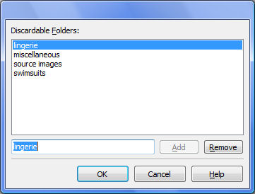

The "Discardable Folders & Files" lists can be edited using the appropriate "Edit" button, which will open the window shown in the following screenshot:
