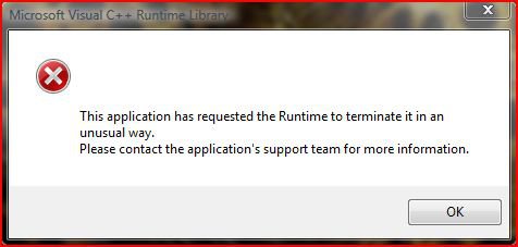

Neither device manager or event viewer are working right now, so I'm going to re-boot then see what happens..
Also, I keep getting the noise that a external device is being plugged in. That little duh doom. But there isn't anything even being plugged in...
[EDIT] Reboot allowed me to access the event viewer and device manager, device manager didnt show anything out of date...
@lemur No Windows Live, FF addons are: avg safe search 8.5, better privacy, location bar, mailcatch temp emails, .net framework assistant, persona's and web of trust.
@zigzag
The source is: Application Error, the Event ID is 1000
Also I keep getting WMI errors and PnP errors in the event log, like constantly they are there.
WMI Error: Event filter with query "SELECT * FROM __InstanceModificationEvent WITHIN 60 WHERE TargetInstance ISA "Win32_Processor" AND TargetInstance.LoadPercentage > 99" could not be reactivated in namespace "//./root/CIMV2" because of error 0x80041003. Events cannot be delivered through this filter until the problem is corrected.
PnP Error: Fault bucket 194465893, type 5
Event Name: PnPDeviceProblemCode
Response: None
Cab Id: 0
Problem signature:
P1: x64
P2: ROOT\CIRClass
P3: {4d36e97d-e325-11ce-bfc1-08002be10318}
P4: 0000001F
P5: circlass.sys
P6: 6.0.6001.18000
P7: 01-21-2008
P8:
P9:
P10:
These files may be available here:
Here is a screenshot from the health check, sometimes that will say 1, sometimes 0.
Another [EDIT] I went onto HP's site to look for new drivers. And every time I see the Intel Display Adapter Driver with version number: 7.15.10.1554 D but when I try to install it the computer says it an old driver? My current driver version is: 7.15.10.1554

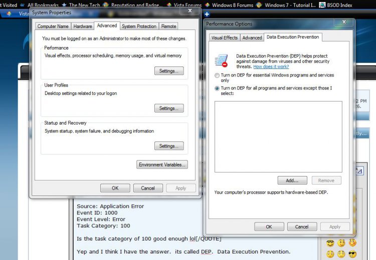

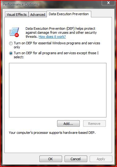

#6
I may have a lead. The laptop I have has a removable CD/DVD drive for weight savings, well yesterday I was going to create system restore disks but it kept popping up saying I didn't have a CD/DVD drive capable of burning the disks. Now, mind you, this is with a brand new never used DVD with 4.7gb of space. I know the drive works because all of my Linux 'Live CD' work flawlessly, so it is burning the info properly. So I'm going to see if I can find the drivers for it or just remove it completely to see if it solves my problems...

Event ID 1000 source ??? I think I might have the answer if the source is 100. check event viewer

I have this from event log:
Source: Application Error
Event ID: 1000
Event Level: Error
Task Category: 100
Is the task category of 100 good enough lol
Event ID: 1000
Event Level: Error
Task Category: 100
Good enough I think I have this one. Its caused by DEP data execution prevention. Its located in control panel>system control panel>advanced system settings>performance settings>DEP it should be on for ALL programs.
let me know if that fixes it
Ken
I just applied the setting, I'll see if it helps, if it doesnt, my dvd drive is next to go, I searched my drive number and a lot of HP machines have problems with applications recognizing that it is active. So until they fix it, that might continue to be a problem :(

It just crashed... Twice actually. The first time I had to do it manually because it stopped everything but the mouse. Next time was like 3 seconds ago and all I did was right click the desktop. Only processes running right now are: firefox and windbg, taskbar apps are: AVG, touchpad, and sound
Then of course, right after explorer crashes the first time, everything goes haywire. I;m attaching a screen shot of the error I get trying to open Event Viewer after explorer crashed.
Idk if this means anything, but I ran driverquery in cmd to see what drivers I had as far as wireless drivers, and it's showing a intel wifi link pro wireless driver, I'm using broadcom right now. Are the two conflicting? Could it be the CD/DVD drive? Also, I always have internet radio running, and sometimes it will stop, and at the bottom of the firefox screen it will say 'Done' instead of 'Transferring Data...'

Ok so the explorer is still at it. anything in evtvwr, or dump? have you done an sfc? Do you have a backup to restore from and a vista dvd?
Check DEP to make sure. If necessary we can exempt it
