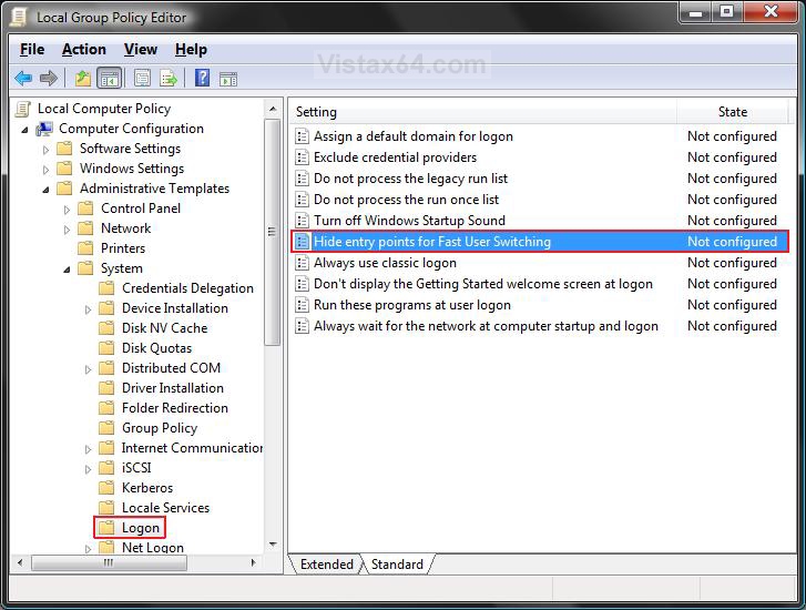

2. In the left pane, click on Computer Configuration, Administrative Templates, System, and Logon. (See screenshot below step 3)​

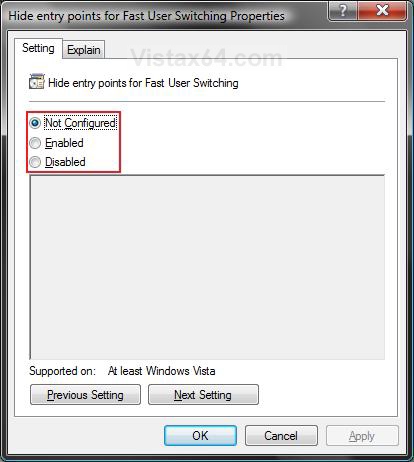

3. In the right pane, right click on Hide entry points for Fast User Switching,and click on Properties.​
4. To Add Switch User Back to All Users
A) Dot Disabled or Not Configured and click on OK. (See screenshot below step 5)​
NOTE: Not configured is the default setting.​
B) Go to step 6.​
5. To Remove Switch User for All Users
A) Dot Enabled and click on OK. (See screenshot below)​

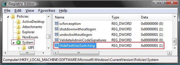

To Add or Remove Switch User for All Users
NOTE: If you do not have System, then right click on Polices and click on New and Key, then type System and press Enter.
Code:
HKEY_LOCAL_MACHINE\SOFTWARE\Microsoft\Windows\CurrentVersion\Policies\System
A) In the right pane of the System key, right click on a empty area and click New and click DWORD (32 bit) Value.​
B) Type HideFastUserSwitching and press Enter. (See screenshot below)​

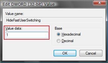

C) Right click on HideFastUserSwitching and click Modify. (See screenshot below)​
E) Go to step 8.​

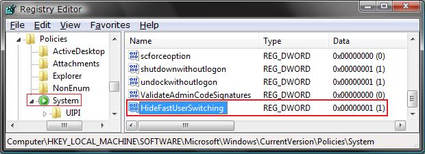

6. To Add Switch User
NOTE: This is the default setting.​
A) Right click on HideFastUserSwitching and click Delete. (See screenshot below step 5C)​
B) Click Yes to confirm the delete.​
C) Go to step 8.​

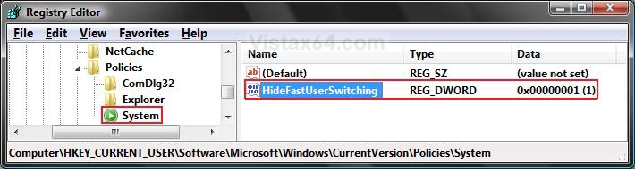

To Add or Remove Switch User for Current User Only
7. In regedit, go to: (See screenshot below)​
NOTE: If you do not have System, then right click on Polices and click New -> Key, then type System and press Enter.
Code:
HKEY_CURRENT_USER\Software\Microsoft\Windows\CurrentVersion\Policies\System
A) Repeat step 5 or 6 above.​
