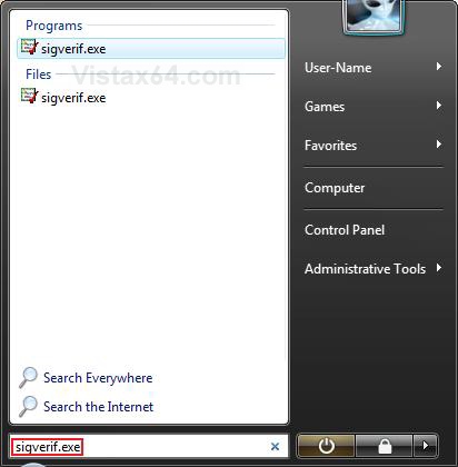

1. Open the Start Menu.
2. In the white line (Start Search) area, type sigverif.exe and press Enter. (See screenshot below)
NOTE: The sigverif.exe file is located at C:\Windows\System32\sigverif.exe.

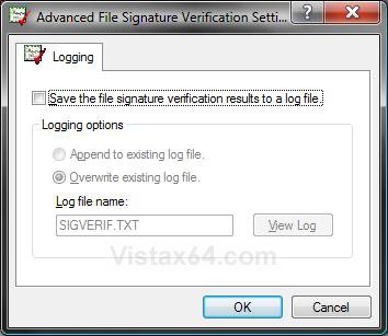

3. To Enable or Disable the Log File
NOTE:
This log file will contain the complete list of the system files checked in File Signature Verification. Without this log file, the only results you will see will be the critical operating system files without a digitally signed signature (step 6).
A) Click on the Advanced button. (See screenshot below)​
B) To Enable the Log File -
  • Check the Save the file signature verification results to a log file box. (See screenshot below)
  • Dot the Logging option that you want.
  • Click on OK.
  • Go to step 4
C) To Disable the Log File -
  • Uncheck the Save the file signature verification results to a log file box. (See screenshot above)
  • Click on OK.

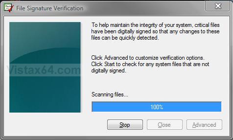

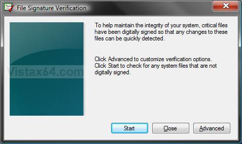

4. Click on the Start button. (See screenshot below step 3A)
5. It will now scan your system files. (See screenshot below)

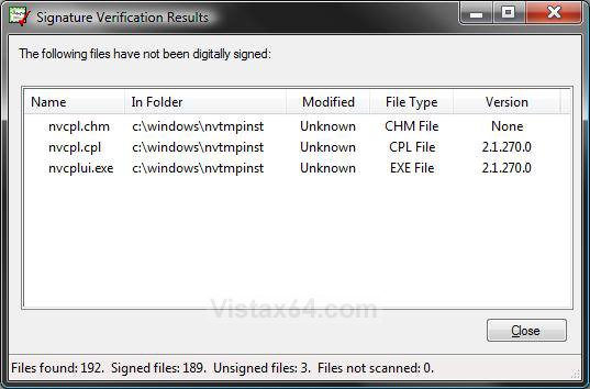

6. When finished, you will get a list of any system files that are not digitally signed. (See screenshot below)
NOTE: Notice that my unsigned files turned out to be safe NIVIDIA video drivers.
A) Click on CLOSE when done.​

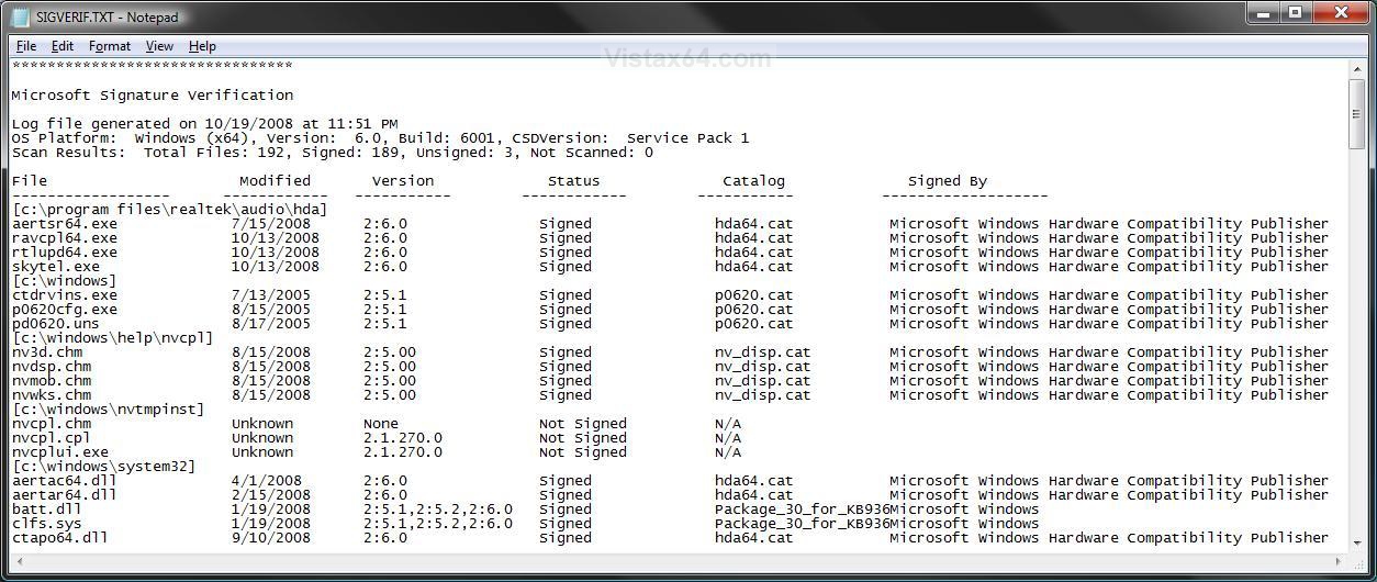

7. To See the Log File
NOTE:
You will not have a log file unless you enable it in step 3. The log file will show you a complete list of the system files checked.
A) Click on the Advanced button. (See screenshot below step 3A)​
B) Click on the View Log button. (See screenshot below step 3B)​
C) Click on the CLOSE button. (See screenshot below step 3B)​
D) Close the SIGVERIF.TXT file window when done. (See screenshot below)​
8. Click on CLOSE when done. (See screenshot below step 3A)
