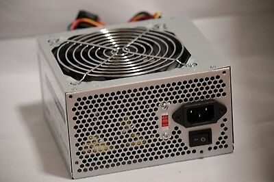

I did a search for your psu and found a bunch of them at ebay but they're either used or refurbished. This one has a higher power rating but it's new-
Here' a brand new one the same as yours-
Costs about $20 more.
You might check all the connections to your psu before buying.

skeezix
Read the reviews for the 2nd link. Most everyone said the cable(s?) were too short. It is unfortunate that nobody bothered to mention either the length of a correct cable or the length of the supplied cable. Not even the manufacturer includes that information. To me, that's just another "sell it and let the buyer deal with the no-fit problem".
It would be nice to know the length I need so I can measure what I have and then order the ATX extension if I need when I order the power supply. Would somebody here happen to know the length of the MB cable that comes with the supply?

skeezix
So I ordered and received a power supply. When I was about to install it, I noticed that the larger connector to the HD was just a bit wiggly so I tugged lightly on it and it came off. Hmmmm. I reconnected it, shoved it in until I heard the little clip lock in place, and started the computer. Evidently that was the problem because for about a week now I have not seen any problems with the computer (knock on wood...)
