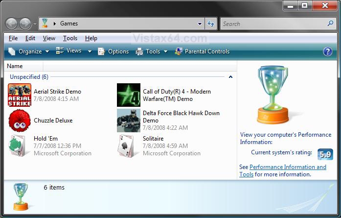

If when you click on the Games Explorer Link in the Start Menu to open it, and it may quickly open and close or not open at all, then this will show you how to fix it so it will open again.
Even though the Games Explorer window will not stay open, you may still be able to run a selected game from the Start Menu, All Programs, Games folder.
EXAMPLE: Games Explorer Window

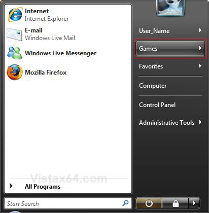

Other than the links below, you can type Shell:Games in the white line (Start Search) area of the Start menu, or in the Run window, and press Enter.
EXAMPLE: Games Explorer Link in Start Menu
NOTE:
To add or remove the Games button, see Option One here: How to Customize the Start Menu in Vista and dot/undot Games. There is also a Games Explorer link at Start Menu, All Programs, Games folder, Games Explorer.

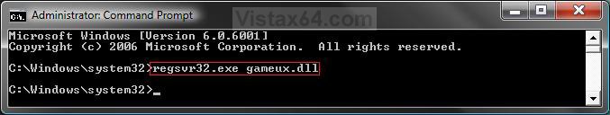

2. In the elevated command prompt, copy and paste the command below and press Enter. (See screenshot below)​
regsvr32.exe gameux.dll

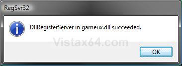

3. Click on OK in the success message prompt. (See screenshot below)​
4. Close the elevated command prompt.​
NOTE: You should now be able to click on the Games Explorer link in the Start menu and have it stay open now.​

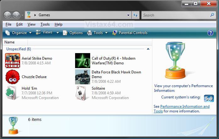

Does it open the Games Explorer window when you type Shell:Games in the white line (Start Search) area of the Start menu and press Enter?

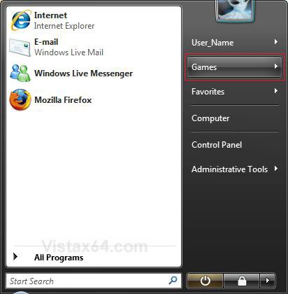

Do you have the Games button on the dark right side of the Start Menu?

ok 1. when i type Shell:Games it opens a folder called Games , its empty
2. yes i do have the games button on the right hand side of start menu , it opens the same folder, empty
