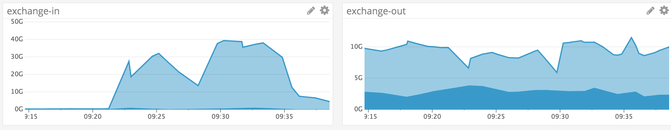

At 17:21 UTC our network monitoring system detected an anomaly in the ratio of ingress to egress traffic and notified the on-call engineer and others in our chat system. This graph shows inbound versus outbound throughput over transit links:

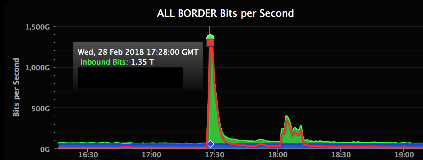

The first portion of the attack peaked at 1.35Tbps and there was a second 400Gbps spike a little after 18:00 UTC. This graph provided by Akamai shows inbound traffic in bits per second that reached their edge:
