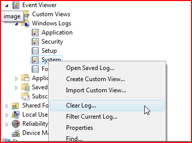

Re: HELP need to solve this problem asap - Unable to start event viewer/event log ser
Try in safe mode. If it works in safe mode, then just clear any system event log.
Look the image below:
