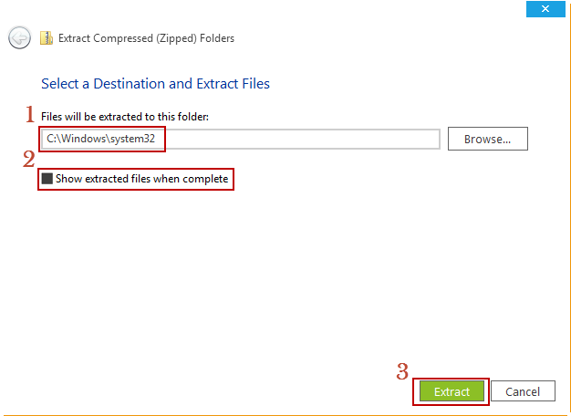

1. Download the above zip file (PsTools.zip) to you Desktop
2. Right Click on PsTools.zip and select Extract All...
3. When the window opens, change the location to C:\Windows\system32\ and uncheck the box Show extracted files when complete
Your drive letter may be different, ie D:\Windows\system32\
4. Once this has finished, we're all good to go!

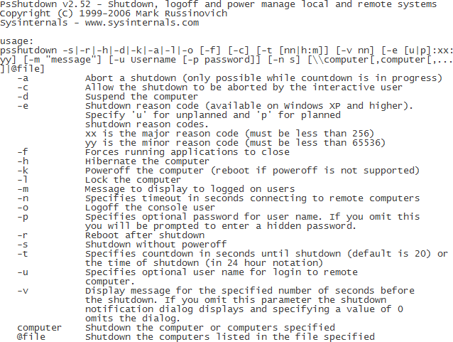

Here is the various switches that can be used with PsShutdown:
As you can see, there's a lot of features!
But we're only interested in two:
-h Hibernate the computer
-t Specifies countdown in seconds until shutdown (default is 20) or
the time of shutdown (in 24 hour notation)
By using both of these switches together, we can delay a hibernate.

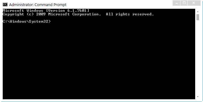

PsShutdown is command line only (a Console Application) so we have to launch command through Command Prompt
Launching Command Prompt:
1. Hold the Windows key and press R to bring up the Run box
2. When the window appears, type cmd in the box and press OK. This will now launch command prompt
3. You should now be presented with a black window with a flashing white line. This is command prompt and this is what we'll be entering our commands in.

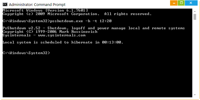

Our current command: psshutdown.exe -h -t 12:20
OR
Our current command: psshutdown.exe -h -t 1200
Once you've typed what you want into command prompt, press enter. Make sure you've typed the right thing!
It should now display a message similar to this:
And there we have it, your computer is set to hibernate after a set period of time :)
