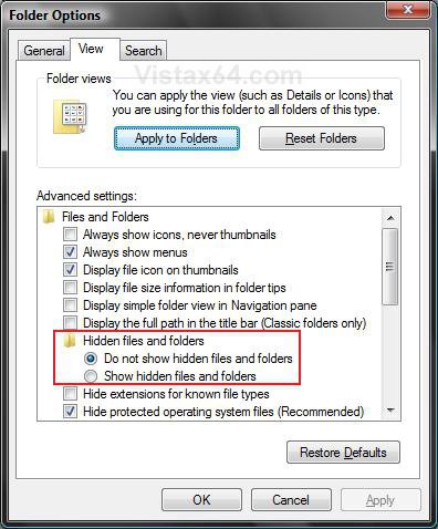

1. To Add "Hidden Files and Folders" to Folder Options
NOTE: This reg download containd the entire contents of the Hidden key, including the NOHIDDEN and SHOWALL subkeys, for a full restore of the Hidden files and folders option.​
WARNING: If you have get a black square(s) instead of the check box next to Hidden files and folders, then use Radio instead of Group in the OPTION TWO (step 6) below to not have the black square.​
Add_Hidden_Files_Folder.reg
download
B) Go to step 3.​

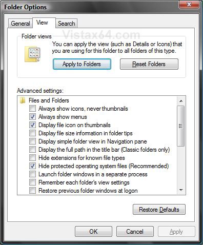

2. To Remove "Hidden Files and Folders" from Folder Options
Remove_Hidden_Files_Folder.reg
download
5. Click on Run, Continue (UAC-Vista) or Yes (UAC-Windows 7), Yes, and then OK when prompted.​
7. Close and reopen Folder Options to see the change.​

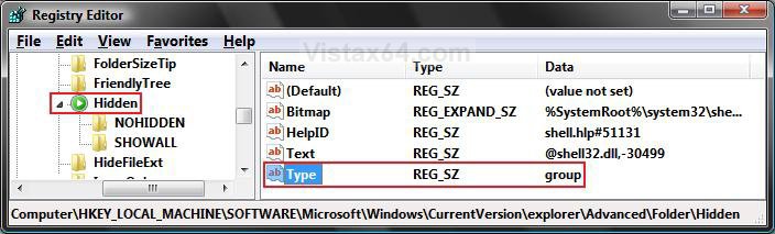

4. In regedit, navigate to the location below. (See screenshot below step 5)​
Code:
HKEY_LOCAL_MACHINE\SOFTWARE\Microsoft\Windows\CurrentVersion\explorer\Advanced\Folder\Hidden
5. In the right pane, right click on Type and click on Modify.​
NOTE: If Type is not there, then right click on a empty area of the right pane and click on New and String Value, then type Type and press Enter.​

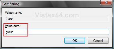

6. To Add "Hidden Files and Folders" to Folder Options
A) Type group and click on OK. (See screenshot below)​
WARNING: If you get or have a black square(s) instead of the check box for the Hidden files and folders option, then type Radio instead and click on OK.​

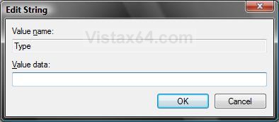

7. To Remove "Hidden Files and Folders" from Folder Options
A) Clear group and leave the field empty. (See screenshot below)​
B) Click on OK.​
8. Close regedit.​
9. Close and reopen Folder Options to see the change.​
