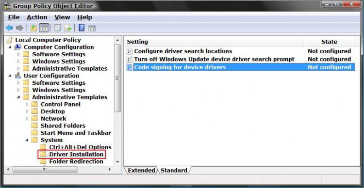

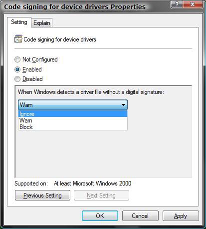

I just got an advice on PlanetAMD64 forum to try through editing gpedit.msc. I think it could work that way, but I am concerned about possibility not to be able to turn driver signing off again if necessary. People on PlanetAMD64 say that it is impossible to turn off driver signing after some KBXXXXX update. I don't want to take the risk.

I'm not sure how that method will affect the Test Mode, but it will let you disable the driver signing check with the Ignore option.

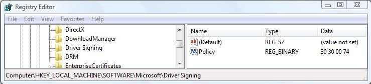

Here is the location in the registry that pertains to driver signing. The values next to 'Policy' are the default ones for Vista Home Premium 32-bit. To modify them, you need to run the registry editor with administrative credentials.
    Dwarf Dwf/11/2012 r09/2013

I know it is, but it might be useful to see how the settings are actually reflected in the registry.
