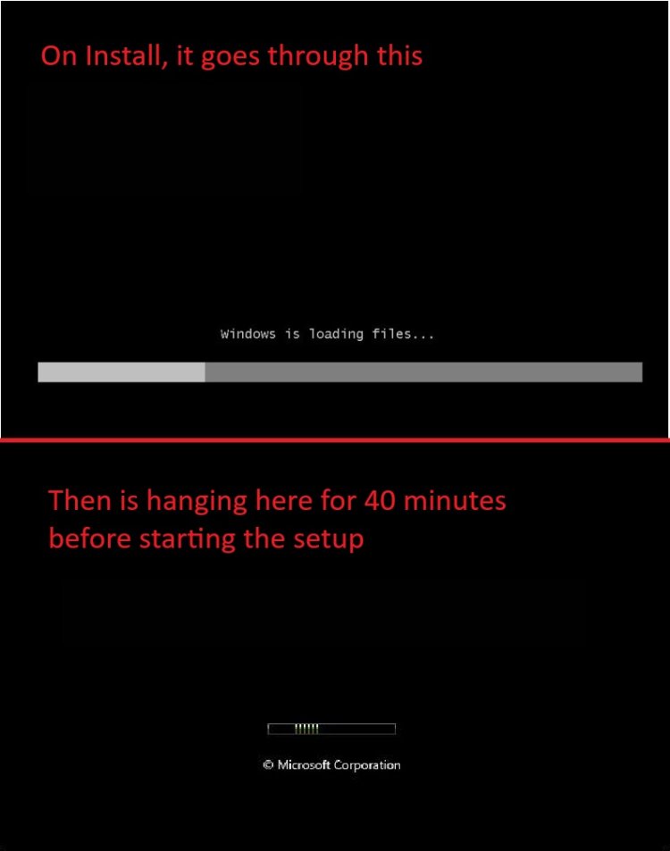

I was running Vista Ultimate SP2 x64 for a long time on my laptop, few days ago I decided to try few different editions of Vista to test the battery life, every time I wiped the SSD and installed them on the unallocated volume, and everything installed smooth. Then I also installed Windows 7 and it all worked great.
When I wanted to install again Vista 2 days ago for some reason is refusing to install/run correctly, after loading the files into the RAM, it stays in on the boot screen for 40 minutes without any disk activity, then during the setup every restart takes around 40 minutes.

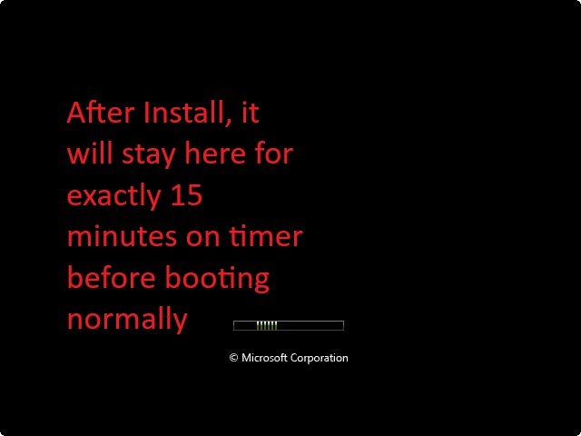

After finally installing when I am on the desktop, the subsequent restarts will always take 15 minutes exactly, it will stay in the boot screen for exactly 15 minutes without any disk activity then finally deciding to boot. If I make it to the desktop, the system is behaving normally, 0% CPU utilization, 500MB RAM usage, is super fast etc.
