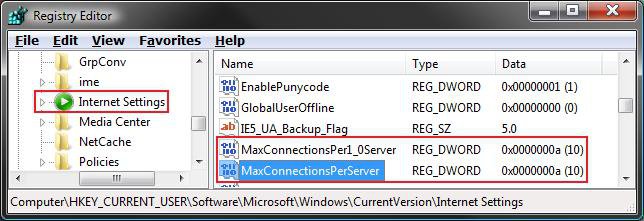

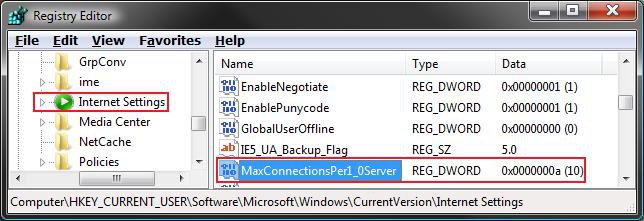

Manually in Registry Editor:
1. Open the Start Menu.​
4. In regedit, go to: (See screenshot below step 5)​
HKEY_CURRENT_USER\Software\Microsoft\Windows\CurrentVersion\Internet Settings

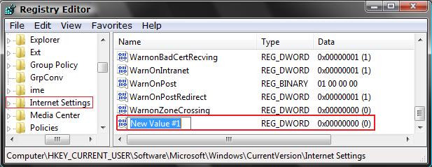

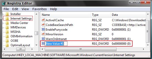

5. In right pane, right click on a empty area and click on New and DWORD (32-bit) Value.​
6. Type MaxConnectionsPer1_0Server and press Enter.​

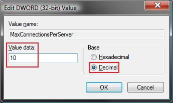

7. In right pane, right click MaxConnectionsPer1_0Server and click on Modify. (See screenshot below)​
8. Dot Decimal, then type 10 and click on OK. (See screenshot below)​
NOTE: The default value is 2, but you can change it to your needs.
9. Repeat steps 5 to 8 above, but use MaxConnectionsPerServer instead now.​
10. When done you should see this below boxed in red.​
11. Close regedit.​
12. Log off and log on, or restart the computer to apply the changes.​

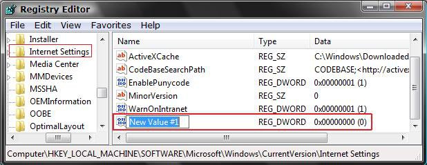

For All User Accounts
Using a REG File Download:
All Users 10Max.reg
download

With regards to the max number i think that the Hexa value should be 0a (10) instead of 10 (16)

Thank you Sid for catching this. The tutorial has been updated to use the correct Decimal settings not Hex.

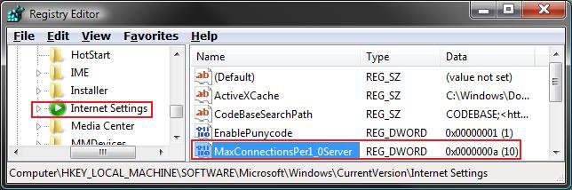

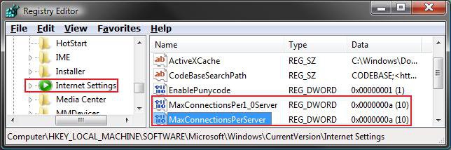

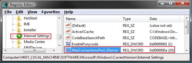

This newbie could use a bit of help. Used the download method on "OPTION TWO" and this is what I have now in
HKEY_LOCAL_MACHINE\Software\Microsoft\Windows\CurrentVersion\Internet Settings:
MaxConnectionsPer1_0Server REG_DWORD 0x0000000a (10)
MaxConnectionsPer1_0Server REG_DWORD 0x00000010 (16)
MaxConnectionsPerServer REG_DWORD 0x0000000a (10)
MaxConnectionsPerServer REG_DWORD 0x00000010 (16)
Is this correct or should everything be at (10)?
I've made no changes in HKEY_CURRENT_USER\Software\Microsoft\Windows\CurrentVersion\Internet Settings, in fact I don't even show a setting for
MaxConnectionsPer1_0Server or MaxConnectionsPerServer there
    Dell Inspiron 530
    Intel Core 2 DuoE4500 2.20G
    3.00G DDR2, 667MHz
    Intel G33/G31 Express 320
    Realtec ALC888 (7.1 Channel audio)
    Dell 22" E228WFP
    Samsung HD501LJ ATA 500 G
    PBDS DVD+RW DH-16W1S ATA
    MAXTOR 320 G USB
    5.28 Mb/s Down, 0.64 Mb/s Up, ATT Dry Loop DSL
Brink
Staff member
mvp
Hi Hdbg62,
You should only have one set in the HKLM section. See the screenshot below step 12 in Option Two.
You will have to create the entries in the HKCU section, but it is not necessary if you have them in the HKLM section since it affects all user account.
The number in the (10) brackets is the Decimal value for 10 in Modify, and the 0x0000000a is the Hexadecimal value for 10 in Modify.
