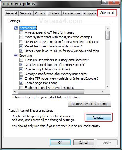

3. Click on the Advanced tab. (See screenshot below)​

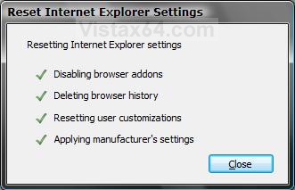

4. Click on the Reset button.​

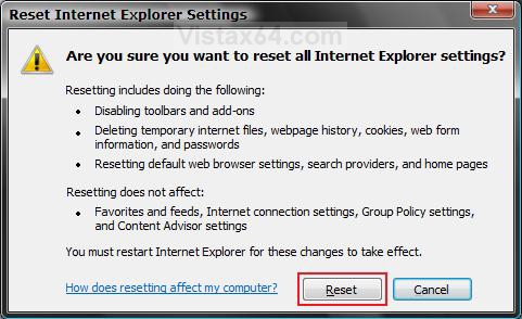

5. Click on Reset to confirm the reset. (See screenshot below)​
NOTE: You will need to do the Apply Actions in Windows Defender if it's icon pops up in the notification area. Just click on the icon. See: How to Change Windows Defender Notification Options
6. Click on Close. (See screenshot below)​

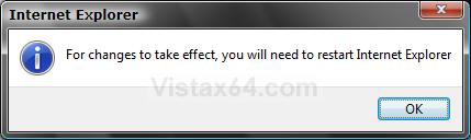

8. Close and reopen Internet Explorer to apply the reset.​

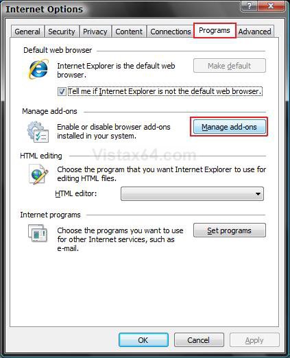

3. Click on the Programs tab. (See screenshot below)​

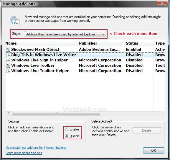

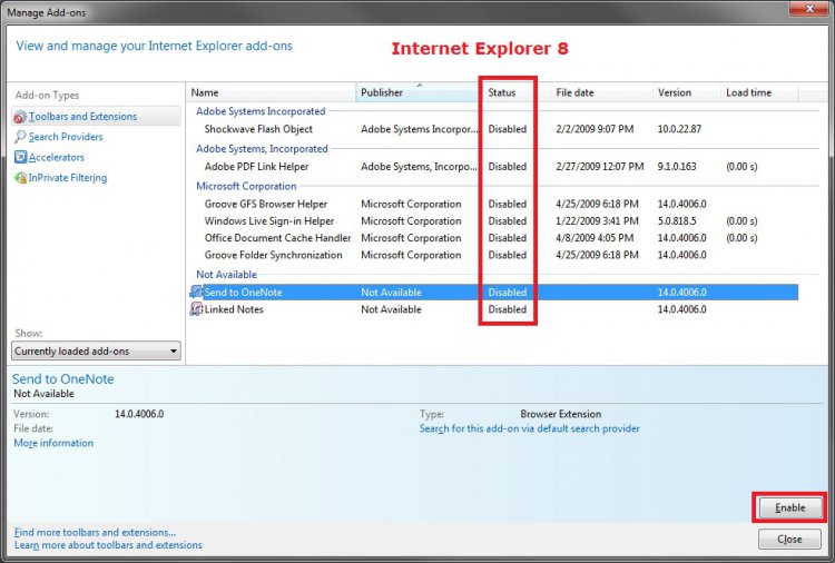

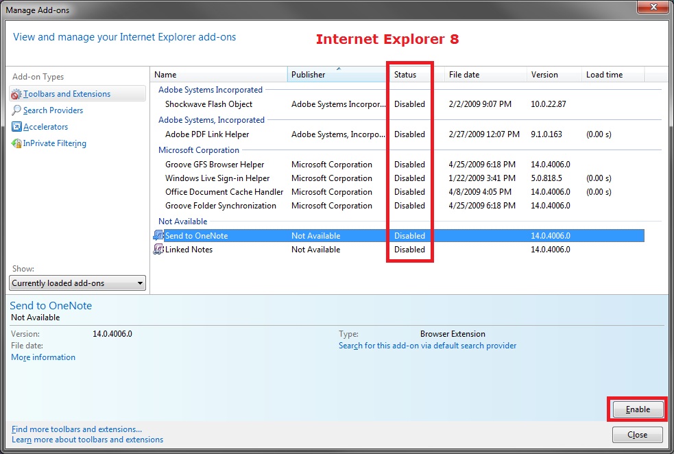

4. Click on the Manage Add-ons button.​
5. Click on a add-on to select it and select Enable. (See screenshot below)​
NOTE: You are trying to figure out which one is bad, so just enable one or couple at a time that you think may be it. Be sure to look in the other Show drop down menu areas.​
A) When the Bad Add-On is Found Select Disable, and click on Delete (IE7) if it is not grayed out to remove it.​

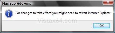

6. Click on OK (IE7) or Close (IE8).​
7. Click on OK to confirm changes. (See screenshot below)​
8. Close and reopen IE to apply add-on changes.​
