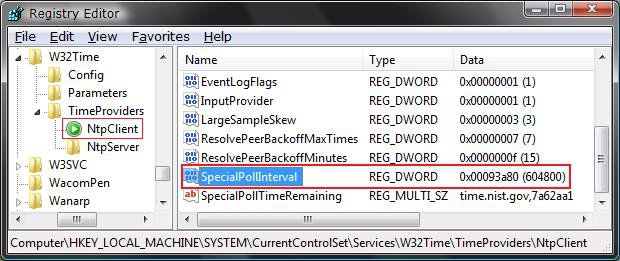

1. Press the Windows+R keys to open the Run dialog, type regedit, and press Enter.​
2. If prompted by UAC, then click on Continue (Vista) or Yes (Windows 7/8).​
3. In regedit, navigate to the location below. (see screenshot below)​
HKEY_LOCAL_MACHINE\SYSTEM\CurrentControlSet\Services\w32Time\TimeProviders\NtpClient
4. In the right pane, right click on SpecialPollInterval and click on Modify. (see screenshot above)​

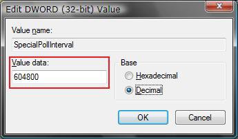

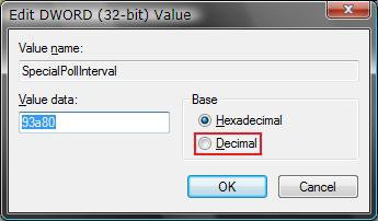

5. Select (dot) Decimal. (see screenshot below)​

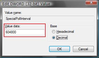

6. Type in how often you want it to update the time in seconds, and click on OK. (see screenshot below)​
NOTE: The default time is every 604800 seconds (7 days). For every day, use 86400 seconds. (60 seconds X 60 minutes X 24 hours X 1 day)
